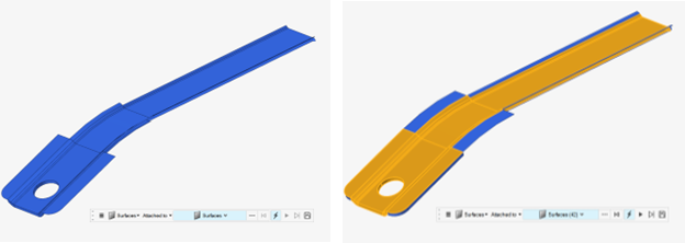

For example, finding surfaces that are attached to the selected surfaces.

are only enabled when the output
and input entity types match. For example, finding surfaces attached to selected
surfaces.

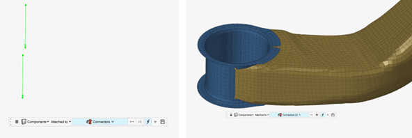

The Attached to function can also be used to find entities that are not the same as the input entity. For example, Figure 2 shows components attached to the selected connectors are found.
