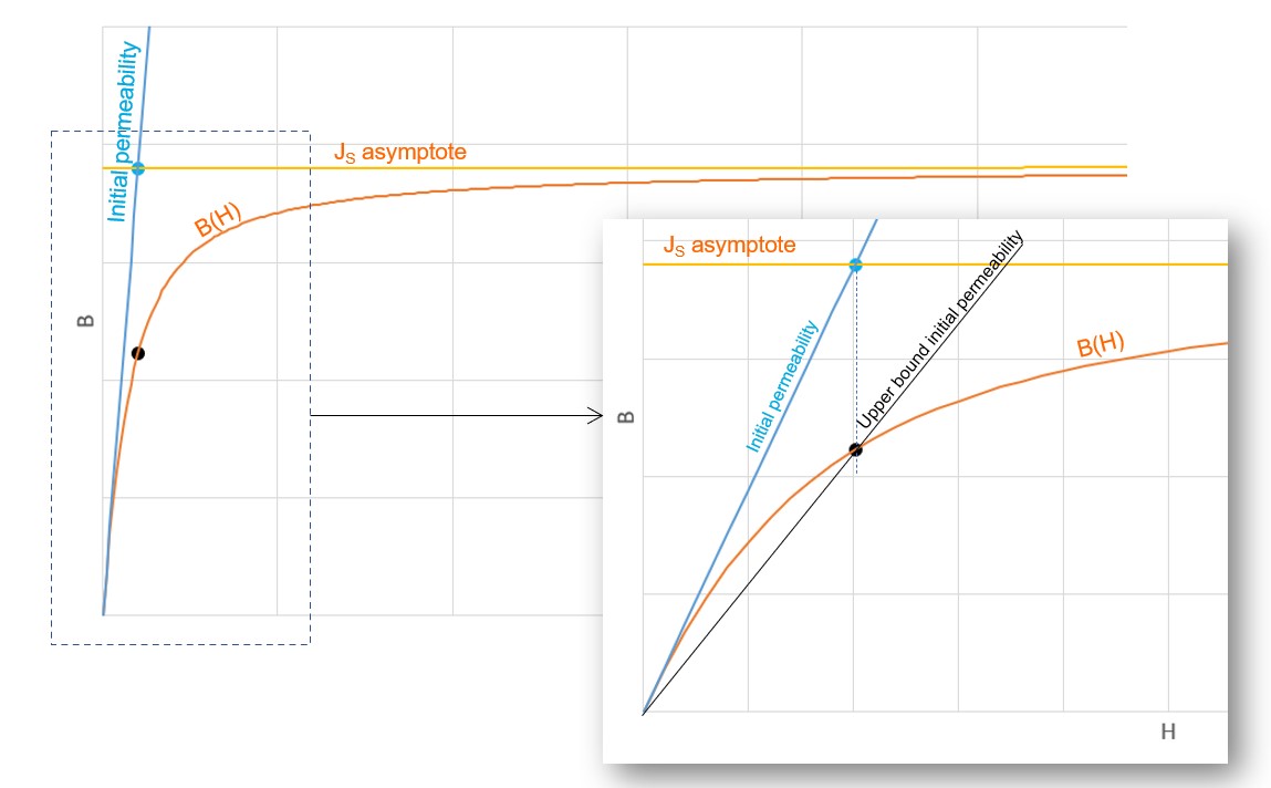

Materials magnetic properties
To meet the requirements of the test assumptions, the computations with Finite Elements are operated by considering linear ferromagnetic materials.
The constant value of each material magnetic permeability is computed by considering a mean value in the very first part of the considered B(H) curve.
From a practical point of view, the constant magnetic permeability used in the computation is the average value of initial and the upper bound permeability defined as below illustrated.
Figure 1. Definition of constant magnetic permeability used for computations with Finite Elements software

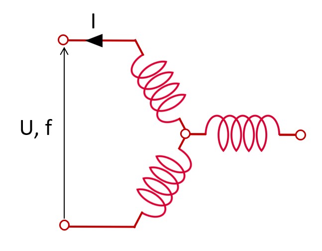

SSFR voltage, h1 rms
The rms value of the SSFR voltage “SSFR voltage, h1 rms” (Voltage between two terminals during SSFR test, first harmonic rms value) must be provided. This value allows us to perform the SSFR test.
Note:
  • The number of parallel paths is automatically considered in the results.
  • The test is always operated by considering a star winding connection.
By default, this input is equal to 0.2 V.
The test procedure for performing the SSFR test consists in applying a fixed low voltage source between two terminals of the machine armature winding (Star winding connection) over a range of frequencies. SSFR voltage corresponds to the voltage source (U) applied.
For additional information please refer to the main principles of computation section.
Figure 2. SSFR voltage (U) applied between two terminals of the machine armature winding
