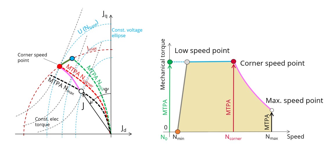

Figure 1. Characterization of the corner speed point on the torque-speed curve
In the results, the performance of the machine at the corner speed point for the maximum speed set by the user is presented.
