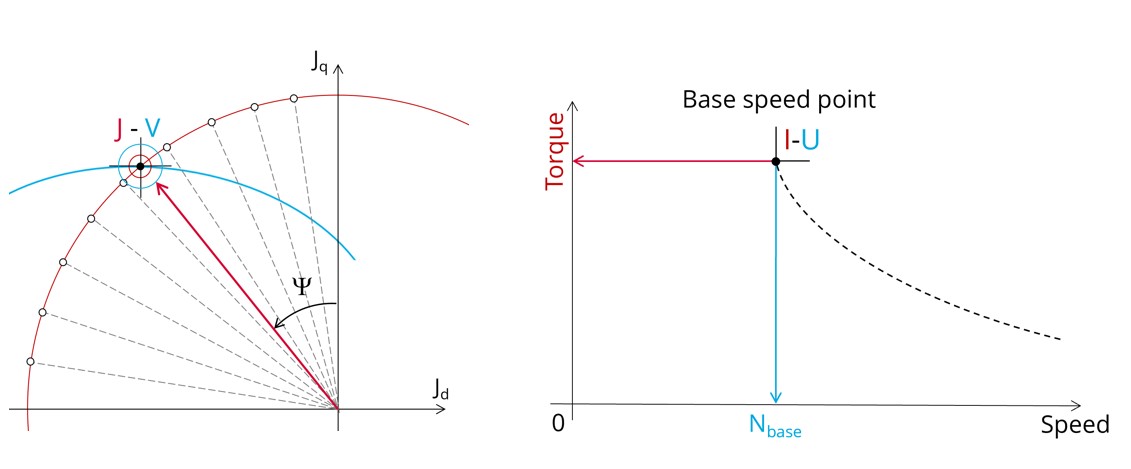

The aim of the test “Working point – Sine wave – Motor – I, U” is to characterize the behavior of the machine when operating at the working point which is targeted by the user. It corresponds to the base point at the imposed maximum line current and maximum Line-Line voltage.
The base point of the torque-speed curve is defined by considering the targeted input values I, U (Voltage, current). Then, this test allows deducing the performance for this working point.
Figure 1. Working point – Sine wave – Motor – I, U - Illustration
