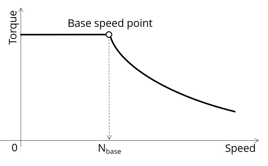

Figure 1. Characterization of the corner point on the torque-speed curve
In the results, the performance of the machine at the base point (base speed point) and the maximum speed (maximum speed point), set by the user are presented.
