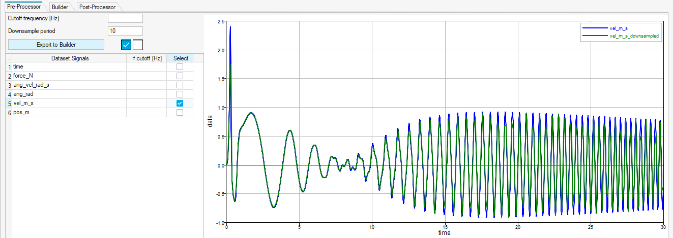

To set the downsampling ratio, enter a value in the Downsample period field, and then press Enter.
図 7. Downsample Data in Pre-Processor Tab

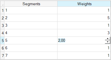

Add a weight to a segment.
To give more consideration to one segment than others, you can add a weight different from one to any segment. As a result, this segment is used multiple times for training with different seeds.
図 12. Weights Column
