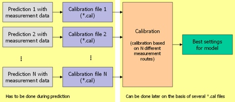

WinProp allows the automatic calibration of nearly all available propagation models based on measurement data. Additionally some propagation models support the calibration of material properties and of clutter / land usage databases. The following table shows an overview of the models and the features:

During the prediction, calibration files are written to the hard disk. The calibration is done afterwards based on the calibration files (.cal).

After the assignment of the measurement files to the transmitters is completed, the wave propagation prediction can be launched as usual. The propagation paths output needs to be activated, otherwise no .cal files will be generated.
For each transmitter (with measurement data assigned) a calibration file (.cal) is written to the hard disk. If the files are missing, click the Prediction tab, under Additional Prediction Data... and select the Propagation Paths check box.
Calibration Computation
Files can be added by clicking Add files. They can be deleted by clicking on Remove file.
