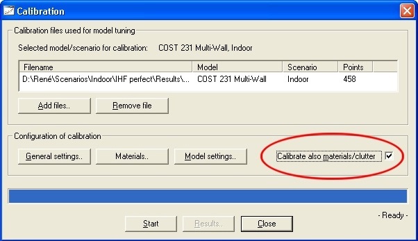

Activate Calibration of Materials
Materials will be calibrated if the current prediction model supports material calibration and if the check box is selected.
