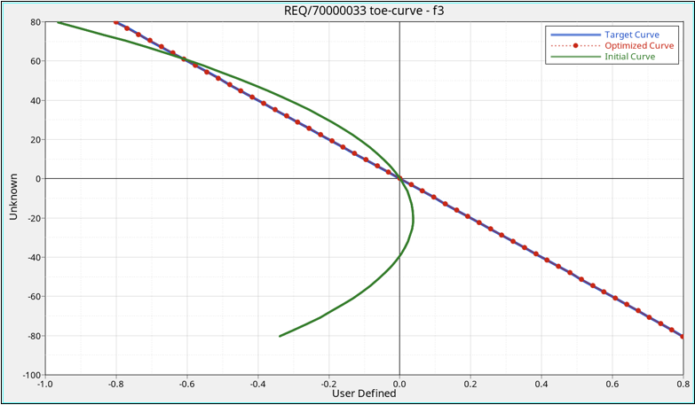

Figure 2. ‘Toe-ride height’ curve of initial design, optimized design and target design You can compare the differences between MotionSolve

Add an HyperGraph page to the
session.
Open the file target_toe.csv.
In the plot panel, change the Type, Request, and Component of x and y
as shown in Figure 8.
Figure 8. Settings to plot target curve
You should see a straight line in the plotting
window.
Navigate to the initial design folder and load the
.mrf file inside.
Change the Type, Request, and Component for x and y as shown in Figure 9.
Figure 9. Settings to plot initial design
Click Apply.
You should see a convex curve representing the 'toe-ride height' of the
initial design.
Go to the subfolder 'iter-18' (the last
iteration).
Import the .mrf file and plot the curve with the same
setting.
The 'toe-ride height’ curve of optimized design overlaps with the target
curve.
