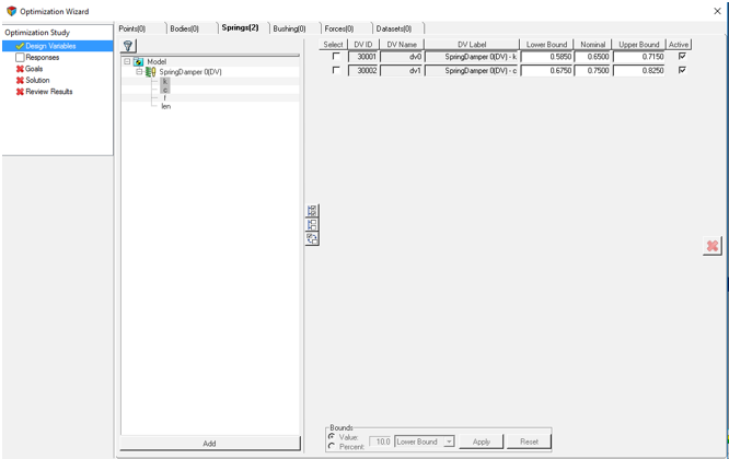

- Open mv_3021_initial_impact_absorber.mdl in MotionView.
- In the Project Browser, right-click on Model and select Optimization Wizard from the context menu.
- Under the Design Variables page, click on the Springs tab.
Make the k and c of SpringDamper
0 design variables. Select k and c
datamembers from the Model Tree under the spring damper
and click Add.
Figure 2. -
Modify the upper and lower bounds of the design variables according to Table 1.
Table 1. DV Lower Bounds Upper Bounds sd_0.k 0.2 1.0 sd_0.c 0.2 1.0
