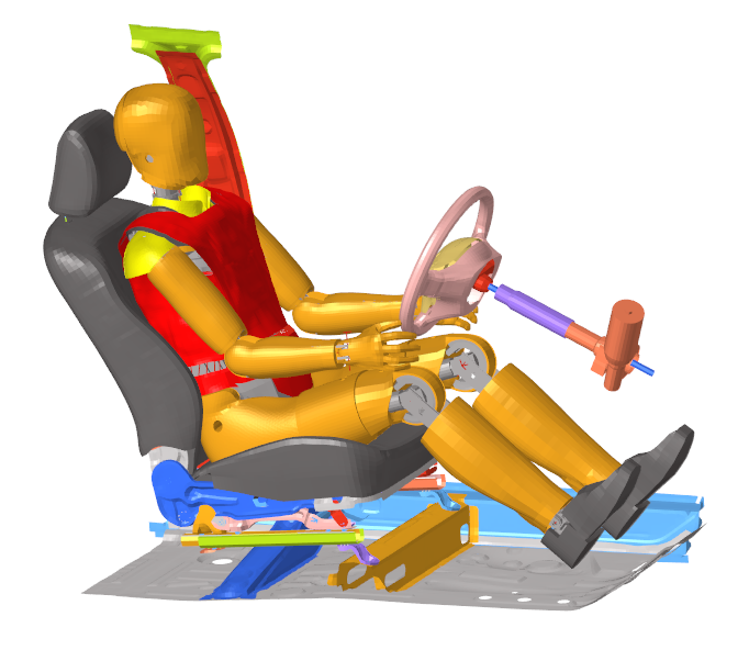

Position the Dummy to its H-Point Location
In this step, you will move the dummy to its H-Point Location on the seat.
  1. From the Safety ribbon, click the Dummy tool.
  2. In the Dummy Browser, click the THOR_FE dummy entity.
    Figure 3.
    The global positioning parameters are activated in the Entity Editor.
  3. For Rx, under Global rotation, enter 180.
    The dummy rotates.
  4. Under H-Point location enter the coordinates.
  5. In the modeling window, select the node tagged as H-Point Location on the seat as seen in Figure 4.
    Figure 4.
    The dummy automatically moves to the selected HPoint location.
