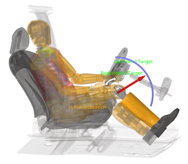

Automatically Position the Hands
In this step, you will position the hands automatically.
  1. In the Dummy Browser, right-click the THOR_FE dummy entity and select Move Limbs from the context menu.
  2. Set Multiple pairs to Yes.
  3. Click the Select pairs field.
  4. Position the left hand.
    1. In the Select multi nodes dialog, Source Point column, click the first cell.
    2. Click the Nodes selector.
    3. Click Node Advanced Selection and enter 420848.
    4. Click OK.
    5. In the Select multi nodes dialog, Target Point field, click the first cell.
    6. In the modeling window, select the node tagged as Left Hand Target as seen in Figure 8.
      Figure 8.
  5. Position the right hand.
    1. In the Select multi nodes dialog, click to add a second row to define the Source Point and Target Point for the right hand.
    2. In the Select multi nodes dialog, Source Point column, click the second cell.
    3. Click the Nodes selector.
    4. Click Node Advanced Selection and enter 320848.
    5. Click OK.
    6. In the Select multi nodes dialog, Target Point field, click the second cell.
    7. In the modeling window, select the node tagged as Right Hand Target as seen in Figure 9.
      Figure 9.
  6. In the Select multi nodes dialog, click Close.
  7. Click Select Bodies.
    Figure 10.
  8. In the Dummy Bodies DOF dialog, enable/disable dummy bodies and body DOFs to be taken into account for the automatic positioning of the dummy limbs.
    1. Deselect the bodies upper_torso and head_neck by clearing their corresponding checkbox in the Body column.
      Tip: You can also deselect a body by right-clicking the desired body in the modeling window. Activate a body or a DOF by left-clicking the desired body or joint arrow in the modeling window.
    2. Click OK to close the dialog.
  9. In the dummyview dialog, click Move to activate automatic limbs positioning.
