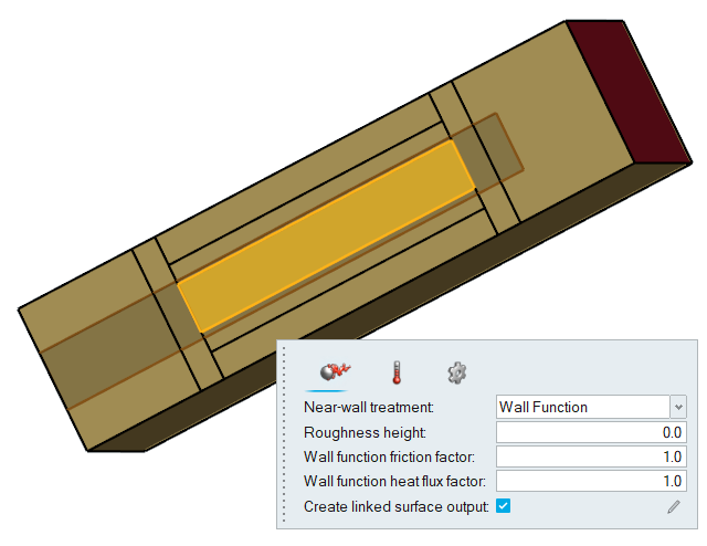

Figure 16. -
Select the face highlighted in the figure below to create the Heated_wall
face.
Figure 17. -
Click the Temperature tab in the microdialog, set the
Thermal Boundary condition to Temperature, and set the
Temperature value to 403.15.
Figure 18. -
