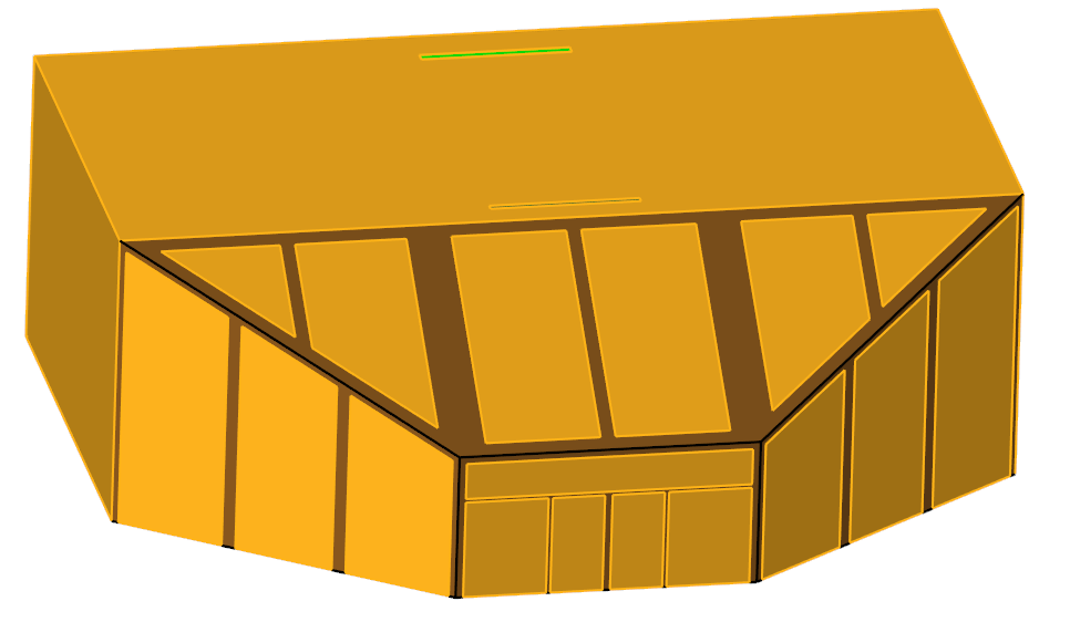

  8. Select all three wall surfaces of the atrium, the roof, and the front glass walls.
    Figure 22. Front-Side of the Model
    Figure 23. Back-Side of the Model
    In total, 21 surfaces should be selected.
  9. In the microdialog, enter the values shown in the figure below.

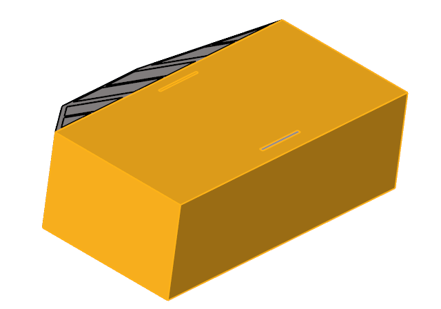

  1. From the Radiation ribbon, click the Surface tool.
    Figure 36.

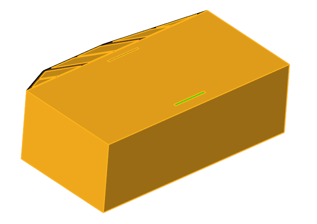

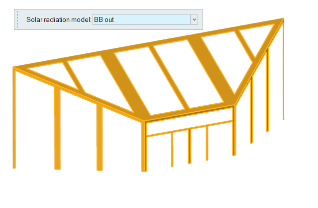

  2. Select the three wall surfaces, the inlet, and the roof surface, as highlighted in the figures below.
    Figure 37. Front-Side of the Model
    Figure 38. Back-Side of the Model
  3. In the microdialog, set the Solar radiation model to BB out then click on the guide bar.

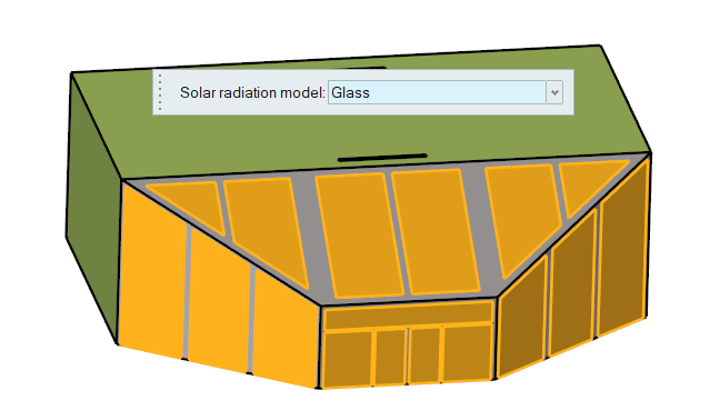

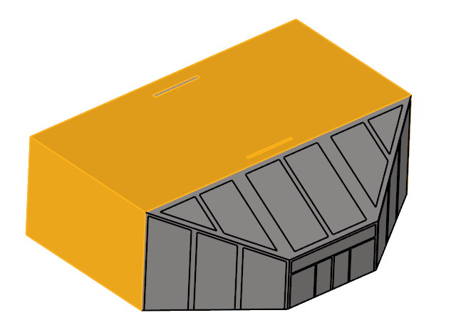

  4. Select all the glass surfaces shown in the figure below, assign the Glass model to them, then click on the guide bar.
    Figure 39.

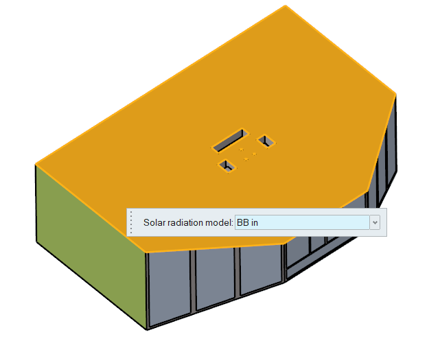

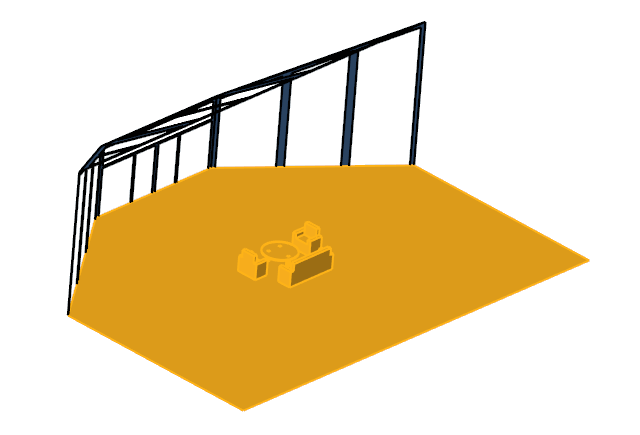

  5. Rotate the model and select the floor surface. In the microdialog, assign the BB in model then click on the guide bar.
    Figure 40.

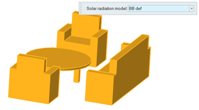

  7. Select the surfaces of the couch, table, and chairs, assign the BB def model to them, then click on the guide bar.

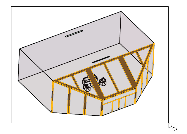

  8. On the guide bar, change the selection entity to Thin Solids.
  9. Using the window selection method, select the four thin solid surfaces and assign the BB out model to them.
    Figure 42.
  10. On the guide bar, verify that the Direction is set to Away from Parent Surface then click to execute the changes.
