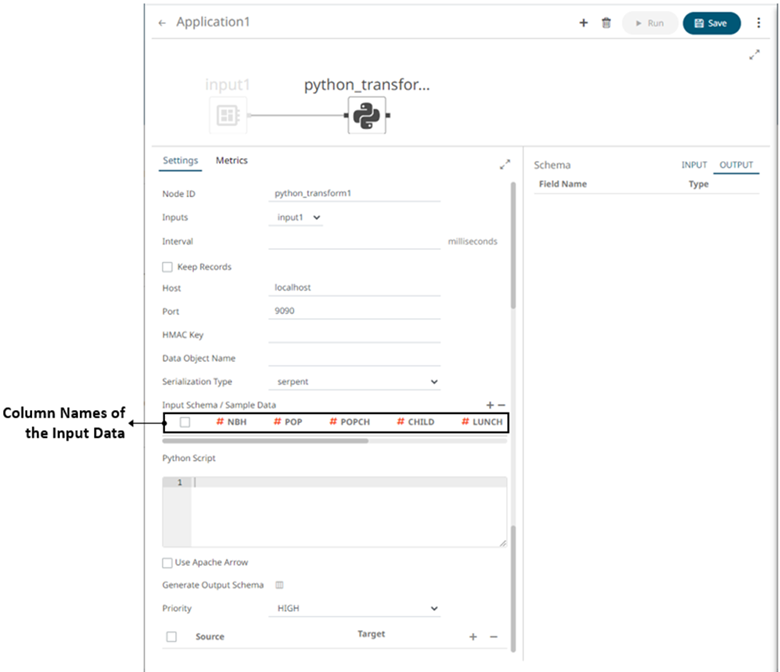

1. On the Application page, click
and select Python Transform
in the Add Operator
pane.
The
Python Transform node
icon displays in the Graph pane, as well as the properties
to be defined in the Operator Settings pane, and the preview
of the data in the Schema pane.
The right (outbound) edge allows you to connect to the other operators.
2. In the Operator Settings pane, define or select the following required properties:
Property |
Description |
Node ID |
The ID of the Python Transform operator. |
Inputs |
The stream of records or input you will be subscribed to. |
Interval |
The interval of which the data should be published to the output stream (in milliseconds). |
Keep Records |
Check to retain or not remove flushed elements. This means the entire set of records will be flushed at each interval. |
Host |
Host of the Python Pyro instance. |
Port |
Port of the Python Pyro instance. |
HMAC Key |
The HMAC key that will be used to connect to the Python Pyro instance. |
Data Object Name |
The data structure (array of dictionaries) that Panopticon will produce, and then will be utilized by the Python Script. |
Serialization Type |
The serialization type: Serpent or Pickle · simple serialization library based on ast.literal_eval · faster serialization but less secure |
NOTE |
The Host, Port, HMAC Key, and Serialization Type fields will be hidden if their corresponding properties are set in the Streams.properties file.
3. Enter the required Python Script to execute on the active Pyro instance.
4. Select the Use Apache Arrow check box to enable fast serialization of data frames in the Python transform.
5. In the Input Schema/Sample Data section, the column names of the Input data source are displayed. In cases where there are no rows from the input data source and the Python script is not handling zero rows, you can add sample data to ensure transform is applied.

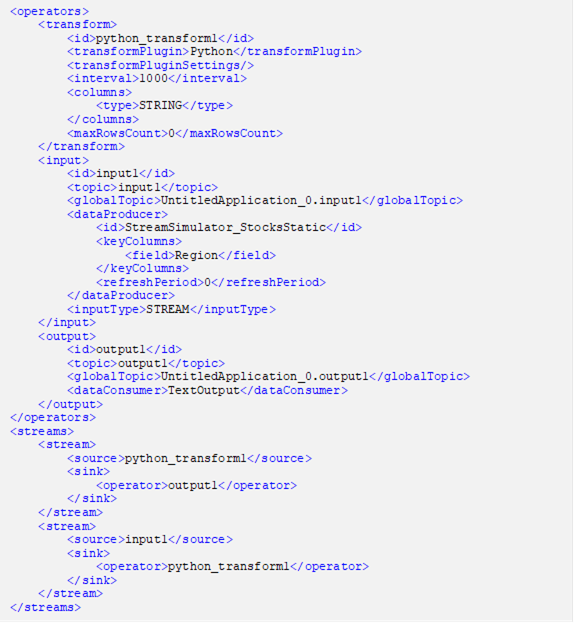

Example
