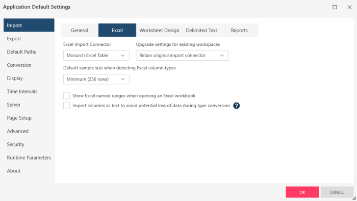

Excel
These settings allow you to specify options when importing new data from Excel.
  • Excel Import Connector
  • Select whether to import new Excel data using the Monarch Excel Table connector (i.e., the Aspose engine) or the ACE OLEDB connector (i.e., the legacy engine).
  • Upgrade settings for existing workspaces
  • When a existing workspace containing an existing Excel data source is opened, select whether to retain the use of the original import connector to load the data or use the Monarch Excel Table connector instead.
  • Default Sample Size
The sample file size specifies how Monarch Data Prep Studio determines the data type of a column coming from Excel.
Take the following example:
Column A
Row 1              1234
Row 2              4569
Row 3              4568
Row 4              4562
Row 5              4562A
If the default sample size is set to 4, Monarch Data Prep Studio will scan up to Row 4 and the column datatype will be Numeric. When the table is displayed, Row 5 will be NULL. If the default sample size is set to 5, Monarch Data Prep Studio will scan up to Row 5 and the column datatype will be Text. All values from Rows 1-5 are displayed.
Select a sample size that ensures Monarch Data Prep Studio can make a correct assessment of the data type. At the same time, be mindful that if you select a very large sample size, you sacrifice speed in loading data.
  • Show Excel named ranges when opening an Excel workbook
Check to import Excel named ranges as individual tables. When you load an Excel source containing multiple sheets and sheets with named ranges, each sheet and named range will be listed as individual tables in the Preview window.
Named ranges will be visible only to Excel workbooks you open after this settings is enabled, including Excel files added to the Prepare window via drag and drop.
This setting is not affected by the “Apply to current workspace” or the “Apply to recent data sources” checkboxes.
  • Import all columns as text to avoid potential loss of data during type conversion
Check to convert all columns imported from the data source as text regardless of their original type. Note that toggling this checkbox in Application Default Settings will not affect the column types in existing load plans.

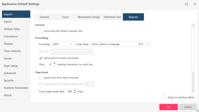

Reports
The following settings allow you to specify options when importing new data from Report files. These settings are also made available to you when you click Report Design Settings > Input in the Report Design window.
Field
Security
Automatically redact sample text
Use this option to automatically redact the sample text line in Report Design.
Formatting
Encoding
Use this setting to specify the default report file format. The following encodings are supported by Monarch Data Prep Studio:
  • ASCII: Select to make Monarch Data Prep Studio interpret report files as ASCII text and perform the conversion to ANSI. This is the default setting because most report files are created as ASCII text files.
  • ANSI: Select to make Monarch Data Prep Studio read report files as ANSI text and perform no conversion. While most report files are created as ASCII text files, report files generated from Windows applications may be created as ANSI text files. The difference lies with characters 128 - 255 in the character set: in these positions, the ANSI character set includes international characters not present in the ASCII character set.
  • UTF-8  (8-bit Unicode Transformation Format): Select to make Monarch Data Prep Studio interpret report files as UTF-8 files. UTF-8 is a variable-length character encoding for Unicode, which is able to represent any character in the Unicode standard, yet it is backwards compatible with ASCII. If a valid BOM (Byte order mark) is detected within the input file, then Monarch Data Prep Studio will automatically select the UTF-8 type when opening the file.
  • UTF-16 LE (16-bit Unicode Transformation format, Little Endian): Select to make Monarch Data Prep Studio interpret report files as UTF-16 LE files. UTF-16 LE is the Unicode Transformation Format that serializes a Unicode value as a sequence of two bytes, in little-endian format. If a valid BOM (Byte order mark) is detected within the input file, then Monarch Data Prep Studio will automatically select the UTF-16 LE type when opening the file.
  • UTF-16 BE (16-bit Unicode Transformation format, Big Endian): Select to make Monarch Data Prep Studio interpret report files as UTF-16 BE files. UTF-16 BE is the Unicode Transformation Format that serializes a Unicode value as a sequence of two bytes, in big-endian format. If a valid BOM (Byte order mark) is detected within the input file, then Monarch Data Prep Studio will automatically select the UTF-16 BE type when opening the file.
  • EBCDIC (Extended Binary Coded Decimal Interchange Code): Select to make Monarch Data Prep Studio interpret report files as EBCDIC files. EBCDIC is an eight-bit character encoding system used mainly on IBM mainframe and IBM mid-range computer operating systems.
These options may also be accessed in open files by right-clicking on the report in Report view.
Code page
Select the appropriate code page to use with the chosen input file encoding format. This option is only applicable to the ASCII (14 codepages available), ANSI (10 codepages available), and EBCDIC (16 codepages available) encoding systems.
File Type
This option is enabled only when EBCDIC is selected as the encoding type. Choose from one of the following options:
  • Auto - Selecting this option instructs Monarch Data Prep Studio to automatically determine the record/line delimiter.
  • Line Feed (LF) - This file type includes files where the end of record is an ASCII line feed character.
  • Carriage Return (CR) -This file type includes files where the end of record is an ASCII carriage return character.
  • EBCDIC New Line (NL) - This file type includes files where the end of record is an EBCDIC new line character.
  • EBCDIC Line Feed (LF) - This file type includes files where the end of record is an EBCDIC line feed character.
  • Fixed-length record - This file type includes files where each line (or record) consists of a fixed number of characters/bytes.
  • Variable-length record - This file type includes files consisting of variable length lines (or records). Each record is preceded by a 4 byte record descriptor that specifies the record length.
  • Variable length block - This file type includes files similar to variable-length records but also includes a block descriptor.
  • Undefined-length record - This file type includes files with no defined record length or block.
  • Custom byte as EOL - This file type includes files where the end of line is marked by a custom number of characters/bytes
Ignore Print Control Characters
Select this setting to have Monarch Data Prep Studio ignore all print control characters below ASCII 32 except for:
  • Form Feed (ASCII 12)
  • Line Feed (ASCII 10)
  • Carriage Return (ASCII 13)
  • TAB (ASCII 09)
  • Null (ASCII 0) which is converted to a space (ASCII 32).
Hide n Leading characters on each line
When you download print files from a network, a mini-computer, or a mainframe, one or more extra characters may appear at the beginning of each line. The exact number and type of characters depends on the operating system. These introductory characters are typically used for form feed, carriage return, or line feed printer commands. They are usually not needed in a PC file and may affect the way the file is displayed by Monarch Data Prep Studio.
A few communications programs are smart enough to either discard unnecessary characters or translate useful characters into the corresponding PC character codes. However, a form feed command is typically the only useful character you may get, and most communications programs are unable to translate it.
Use this setting to specify the number of leading characters to strip from each line of the report. Typical values are 0, 1, and 2. The value can be in the range 0 - 99.
For example, if you download from an IBM 3090 mainframe computer using an IRMA communications card, each line in the report will be preceded by two non-productive characters. You can strip those characters from the data by entering 2 in the Hide leading characters box.
Page Break
Ignore the Form Feed Character
Selecting this setting causes Monarch Data Prep Studio to ignore all form feed (page break) characters in a report. Use this setting to turn off the hard-coded page breaks in a report file and replace them with page breaks based upon a Page Header trap or based upon the ForcePageBreakAfter n Lines setting (see below).
Page break on hidden leading text: n
For some mainframe and midrange system generated reports, especially from AS/400 systems, a page break could be indicated by a leading control character in the report file. This option allows you to hide the control character and to force a page break when a specified character is encountered.
Note: This option is not accessible unless you specify a Hide n Leading Characters setting.
Force page break after n lines
Use this setting to add page breaks to a file at regular intervals by specifying the number of lines you want on each page. Monarch Data Prep Studio scans the report for existing page breaks and inserts a virtual page break whenever a real page break has not been encountered before the number of lines specified.
The action of this setting is modified by the ForcePageBreakLookAhead setting.

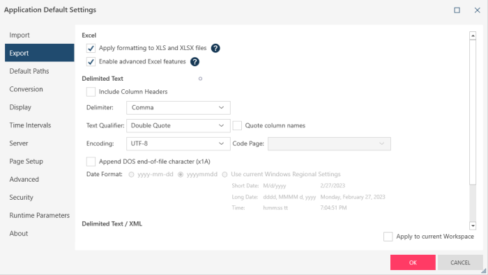

Export
These settings allow you to specify how exports should be created.
  • Apply formatting to XLS and XLSX files (Y/N)
Enabling this setting will direct Monarch Data Prep Studio to apply formatting settings, such as column formats, page setup settings, and summary color settings, when tables are exported to the XLS and XLSX formats.
  • Enable advanced Excel features (Y/N)
This setting instructs the application to enable advanced Excel features during export
  • Delimited Text
These settings instruct Monarch Data Prep Studio how to read delimited text files, including:
  • Include column headers (Y/N)
  • Delimiter
  • Text qualifier
  • Quote column names (Y/N)
  • Encoding
  • Code page
  • Append DOS end-of-file character (x1A)
  • Date format (with option to use current Windows Regional Settings)
Delimited Text / XML
  • Legacy compatibility mode - Ignore format customizations during export (Y/N)
Enabling this setting will cause column format customizations to be ignored during the export of numeric and date columns in favor of Monarch Classic style formatting. When using Monarch Classic formatting, numeric values are exported using the current system's localized decimal separator. Date values are exported according to the Date Format setting.

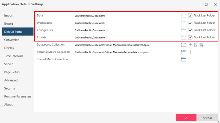

Default Paths
Specifying Default Folders
By default, Monarch Data Prep Studio saves all work data, workspaces, changes lists, exports, and data source (i.e., library) catalog files to C:\Users\Public\Documents\. You can configure Monarch Data Prep Studio to save to a different folder by clicking on the Folder icon that displays beside each field. To enable folder tracking (i.e., use the last-accessed folder for subsequent file opening/saving activities), tick the check box for Track Last Folder. Note that changes to this setting are reflected only when the current Monarch Data Prep Studio session is closed and a new one is opened.

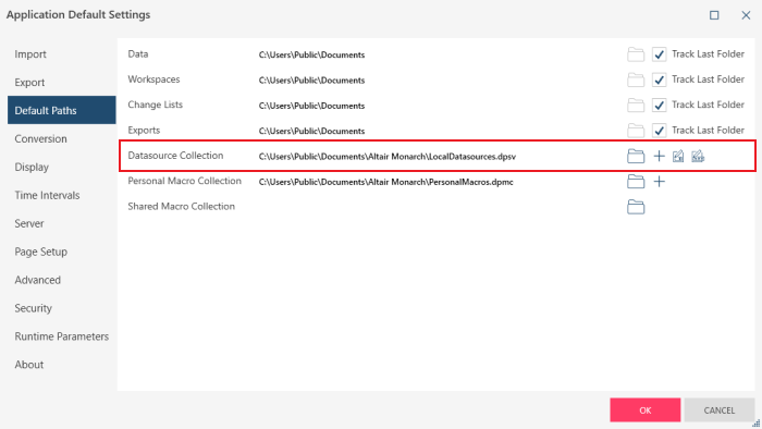

Specifying the Path to a DataSource Collection File
If you wish to create "snapshots" or backups of your library for easy access to previous versions of a specific data source or data sources, you can create a Datasource Collection file and store it in some location of your choosing via the Application Default Settings > Default Paths tab.
You can open a saved Datasource Collection file by clicking the icon in the Datasource Collection setting. To create a new Datasource Collection file, in the Datasource Collection setting, click the Create a new Datasource Collection file icon to launch a file browser, and then use this browser to specify a filename and location in which to store your file. Click Save on the Save As dialog and OK on the Application Default Settings dialog to save and apply your changes. Note that, when a new file is created, the default path automatically switches to this new file; no change to the previous library file occurs.
To copy the current library to a Datasource Collection file without a password, click the Current Datasource Collection Save As icon and then use the dialog that displays to specify the filename and location in which to save your file; to save this file with a password, click the Current Datasource Collection Save As with Password icon instead.
The Create a new Datasource Collection file, Current Datasource Collection Save As, and Collection Save As with Password commands do not overwrite the original/previous library file unless you choose to (by selecting the original file instead of specifying a new file name). In this case, the file path does not change and the original file is deleted in favor of the newly created library file.
Click OK on the Application Default Settings dialog to save and apply your changes.

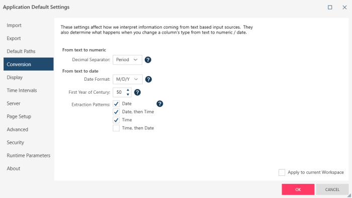

Conversion
These settings affect how information  from text-based data sources is interpreted and converted to either the numeric or date/time format. You can specify a decimal separator (for converting text to numeric) and a date format, first year of century, and date/time extraction pattern. Ticking the Apply to current workspace check box applies all of your settings to any open workspace.
Note that while most data sources, such as delimited text, excel, XML/JSON, etc., will correctly use the default column format settings to display the data. Monarch files will not use the default column format settings of the workspace since the column formats are applied in Monarch Data Prep Studio and attached to the model when exported. Files opened in Report Design (such as Text and PDF Reports) also do not take into account the default column format settings since each field created in Report Design allows the column formats to be set within Report Design. These column formats take precedence over the default column format settings of the workspace.

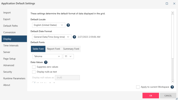

Display
These settings allow you to specify the default format when data are displayed in tables. The Default Locale parameter sets the global language to be used by the application. The Default Date Format parameter specifies the default format of date/time columns.
Note that while most data sources, such as delimited text, excel, XML/JSON, etc., will correctly use the default column format settings to display the data, Monarch files will not use the default column format settings of the workspace since the column formats are applied in Monarch Data Prep Studio and attached to the model when exported. Files opened in Report Design (such as Text and PDF Reports) also do not take into account the default column format settings since each field created in Report Design allows the column formats to be set within Report Design. These column formats take precedence over the default column format settings of the workspace.

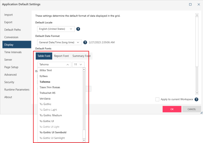

Default Fonts
The Default Fonts setting includes three tabs, each of which will help you assign a default font and font size to tables, reports, and summaries.
Data Values
Field
Suppress zero values
This option, when selected, suppresses zero values when viewing data in the Table and Summary windows. Suppressed zeros are not printed, but are exported as zero values when the Table or Summary data is exported or copied to any format except text. For text export and copy operations, the suppressed zeros are exported as space characters to retain column integrity.
Note that Monarch Complete implements zero suppression based upon the value that is returned to each cell after any rounding has been done on the value. For example, if you set the precision of a cell containing the value 0.004 to two decimal places, Monarch Complete will round the value to 0.00. Since this value equates to zero, it will be suppressed if zero suppression is turned on. This is not the case in other applications, such as MS-Excel, where the underlying value 0.004 is retained and evaluated against zero. In Excel, the cell would be displayed as 0.00 and would not be suppressed, since its underlying value (0.004) is not equal to zero.
Display nulls as text
Display null values as
This option determines how null values will appear on screen in the Table and Summary windows. You may enter a text string to use when representing null values. The string will be displayed using right justification.
In Monarch Complete, as in most other database applications, a null value represents an unknown value or a value that cannot be calculated. Monarch Complete returns null values under a variety of situations:

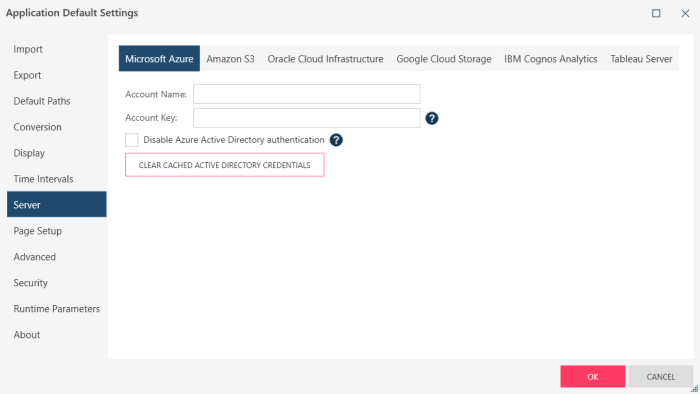

Server
Allows you to set connection settings to the following servers:
Server
Required Fields
Microsoft Azure
  • Account Name
  • Account Key
If Active Directory authentication is enabled, this field becomes optional.
  • Disable Azure Active Directory authentication
If this option is selected, you must enter an Account Key in order to access data from Azure Data Lake Storage Gen 2.
  • Clear cached Active Directory credentials
Clicking this button clears all cached Active Directory credentials
Amazon S3
  • Access Key
  • Secret Key
  • Default Region Endpoint
Oracle Cloud Infrastructure
  • Access Key
  • Secret Key
  • Default Endpoint (URL)
  • Validate endpoint format
Clicking this button instructs the application to check whether the endpoint format was correctly provided
Google Cloud Storage
  • Access Key
  • Secret Key
IBM Cognos Analytics
  • Server URL
Tableau Server
  • Server Address
  • Username
  • Password
  • Proxy Address
  • Path to TABCMD

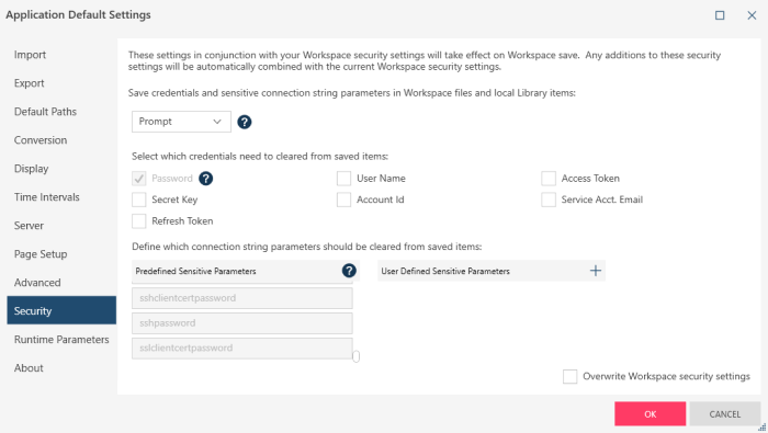

Security
These settings describe how passwords should be handled when saving workspaces in Monarch Data Prep Studio.
Saving Data source passwords and sensitive connection string parameters
This setting tells Monarch Data Prep Studio what to do with passwords and sensitive connection string parameters from data sources and connections in workspace files and local library items. This setting only affects local workspace and library save behavior.
You can instruct Monarch Data Prep Studio how to save passwords and sensitive connection string parameters in one of three ways:
  • Always  - Always save the password/sensitive connection string parameter each time you save a workspace or data source without prompting
  • Prompt - Prompt whether to save the password/sensitive connection string parameter each time you save a workspace or data source. The following prompt displays.
  • Never - Never save the password/sensitive connection string parameter when the workspace or data source is saved.
Credentials to Clear from Saved Items
This settings specifies what types of credentials should be cleared from saved items, such as workspaces:
  • Password (always deleted when clearing is employed)
  • Account ID
  • User name
  • Service account email
  • Access token
  • Refresh token
  • Secret key
Sensitive Connection String Parameters
This list identifies strings that should be considered a sensitive connection parameter when saving details for OLE DB data sources and connectors for which the field Other Connection Options is provided in the connection dialog. When Monarch Data Prep Studio saves a connection detail and encounters the specified sensitive connection parameter (e.g., "password"), it "scrubs" (i.e., deletes) the selected string according to the save behavior defined:
  • Always - Saves workspace as is without clearing any credentials. When this option is selected, all passwords and credentials are saved, regardless of the parameters indicated in the Sensitive Connection String Parameters list.
  • Prompt - Returns a prompt asking the user whether to save the string credentials or scrub them clean if data sources containing passwords or parameters matching any entry in the Sensitive Connection String Parameters list are used in the workspace
  • Never - Scrubs all passwords and sensitive connection string parameters from all connections in the workspace before saving
Note: Microsoft Jet/ACE drivers use a specific password parameter for connection strings that must be added to the default clearing settings to maintain parity with password clearing in other sources.
This parameter is: "Jet OLEDB:Database Password"
This parameter will be added to the default parameters in its normalized, lower case form and will appear as: "jet oledb:database password"
