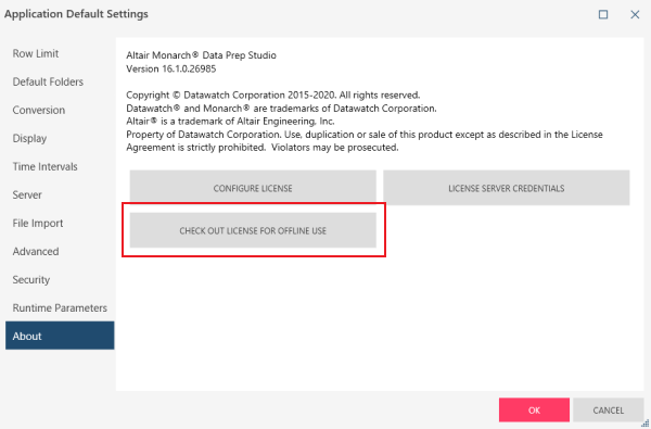

  1. In Data Prep Studio, clic Settinkgs > Application Default Settings > About > Check Out License for Offline Use.

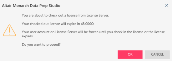

    The following dialog displays.
  2. Click OK to continue checking out your license.

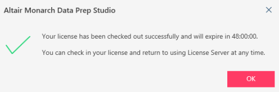

    When the checkout operation is successful, the following message displays.

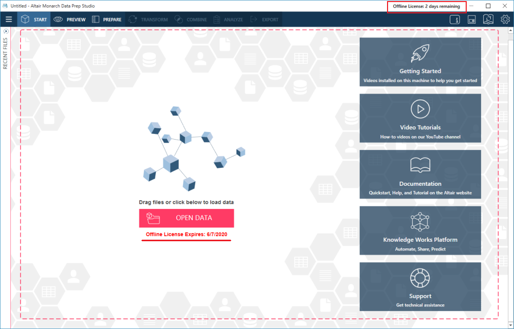

    Note that the amount of time you can use your license offline depends on the license settings.

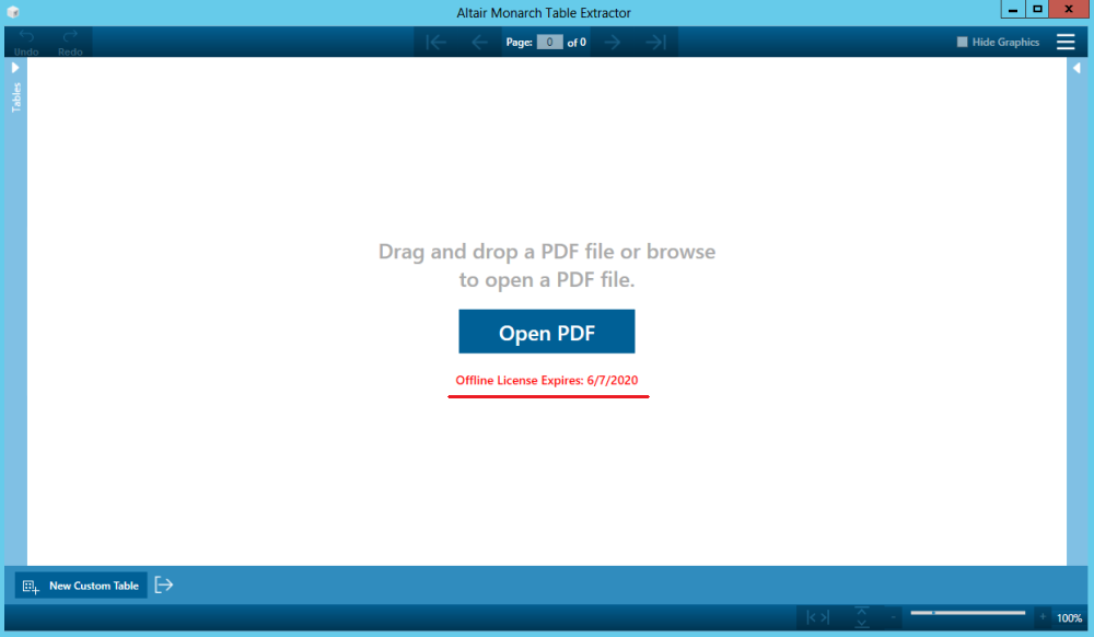

    While your license is checked out, indicators display on the start pages of Data Prep Studio and Monarch Table Extractor to remind you when your license must be checked back in.

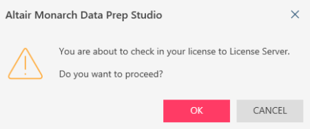

  2. Click OK to continue checking your license in to License Server.

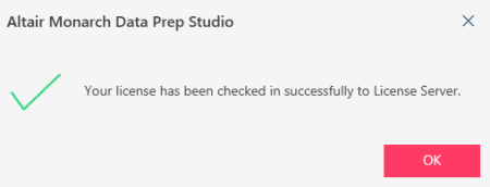

    You can now continue using Data Prep Studio in online mode.
