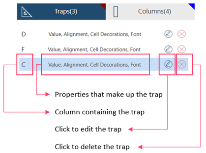

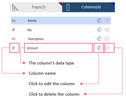

Trap List/Column List
Displays the traps and columns defined for the currently selected template on the Template List (see #3 above).
You need to select either the Trap or  Column tab to display traps or columns respectively. The dark blue background color indicates the currently-active tab. The number beside the header indicates the number of traps or columns currently defined.
This shows the Traps list:
This shows the Columns list:
Refer to Defining Traps for more information on traps and columns.

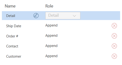

Easily create an Append Template.
Click on a cell containing an append value and select this button.
An append template will be created, together with a trap and column definition.
Note:  This option is also available on the context menu for cells and rows.

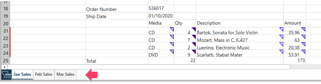

8
Worksheet Display
Displays the worksheet you have opened.
You can control how much data is displayed by using the display controls (see #11 below).
Controls directly beneath the Worksheet Display allow you to select a specific worksheet to and filter worksheets by name:
