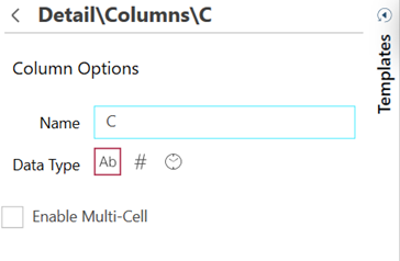

  3. Modify column names and properties.

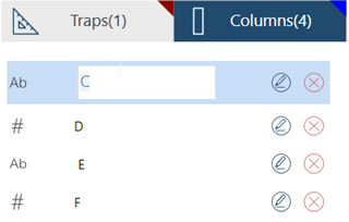

    By default, columns are assigned the column name where they come from. You can rename a column in several ways:
    • Double click on the name on the list and edit the name:
    • Click the edit button  beside the column to display column properties and change the name:
    • At this point you can also change the column's data type .

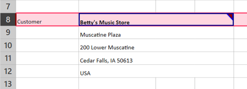

Defining multi-cell columns
Sometimes you need to pick up column values that span several cells, like the address on this worksheet:
To consolidate cell value into one column, activate Enable Multi-Cell on the Column properties:

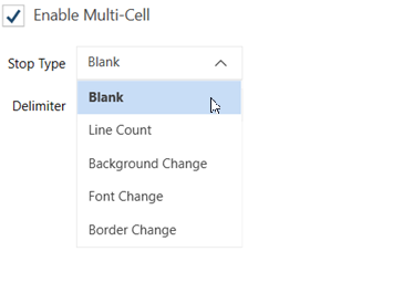

  1. Click the edit button  beside the column to display column properties. The properties panel displays.
  2. Click the Enable Multi-Cell box.
  3. Select the stop type:
    The stop type tells Worksheet Design the end of the multi-cell value. This can be:
    • a blank cell
    • a specific number of lines (e.g. an address is consistently five lines)
    • when the cell background changes
    • when the font changes
    • when the cell border changes
     In our example, the address stops on a blank cell.

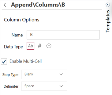

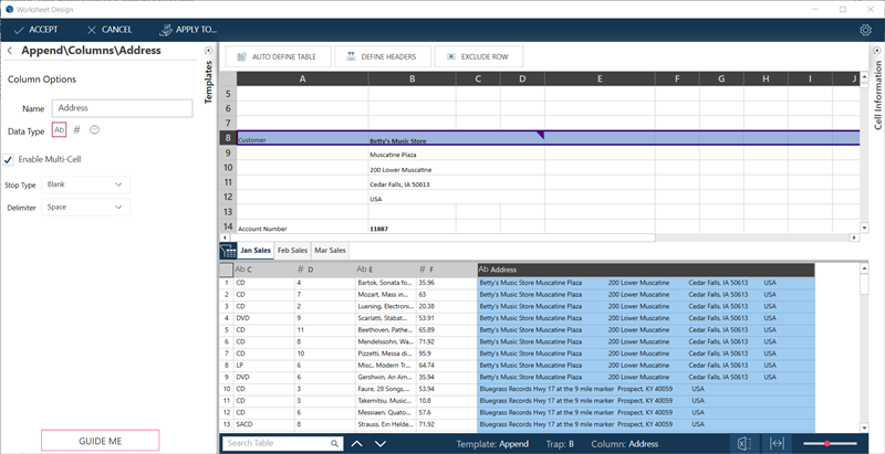

  4. Select the delimiter.
    The delimiter will separate the cell values when they are extracted and displayed in one column.
    The preview grid shows how the address is extracted and displayed with space as the delimiter:
