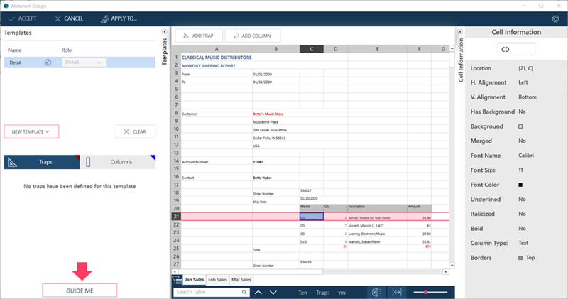

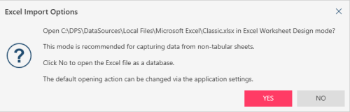

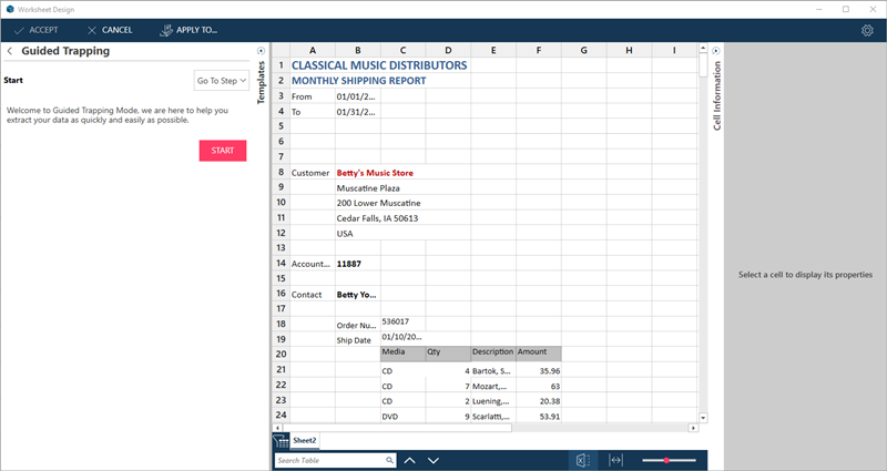

Open your Excel file in one of two ways:
Drag the Excel worksheet into Monarch Data Prep Studio and select Yes when the Excel Import Options dialog displays:
Go to Open Data > Spreadsheet > Excel Worksheet Design
Select Guide Me at the bottom of the Templates panel:
The Guided Trapping interface overlays the Templates panel:
Select Start. You are asked to select a detail row:

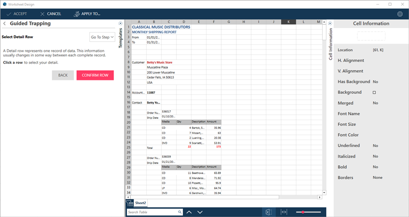

Note that in this step, the Wizard is helping you with the first major requirement in creating templates: define the detail template first.
What you need to do is look for the lowest level of repeating rows, the detail rows in reporting language. If you are not familiar with the worksheet, you may need to scroll down to determine this.
Select a detail row and then select Confirm Row.

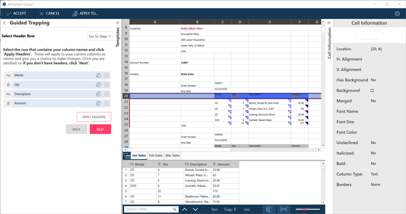

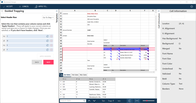

You are next asked to identify the header row.
This step should be easy: if your details have a header, select the row showing the headers and then select Apply Headers. If there are no headers, select Continue.
If you selected headers, these are applied. They are reflected on the preview grid as well as on the list of traps:

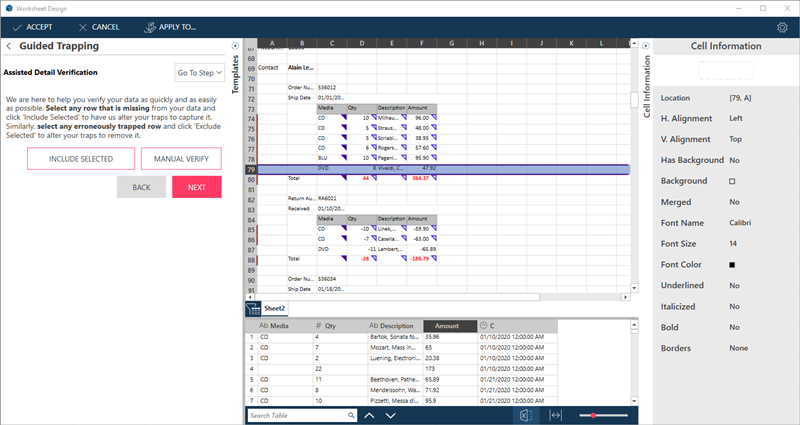

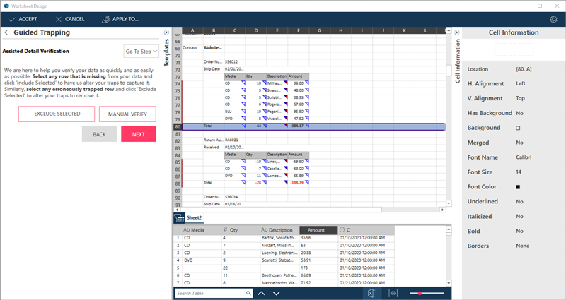

You are next asked to verify your Detail:
In this step, you are asked to verify detail rows.
There are two ways you can do this: Manual or Assisted.

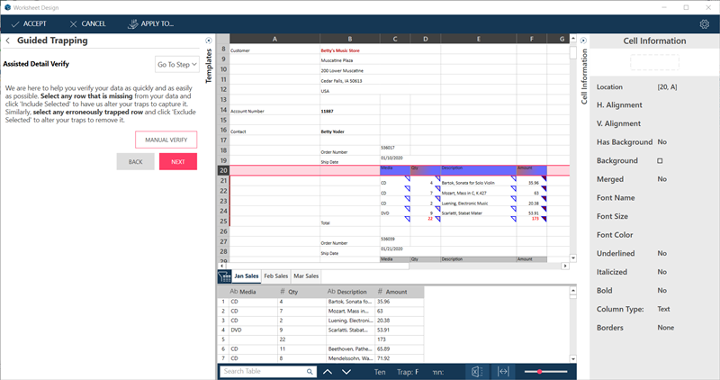

Select Assisted Verify to have the Wizard do the adjustment for you:
In this method, you select or unselect detail rows and the Wizard will try to adjust the traps to meet your selection criteria.
Click on a row that should be included as a detail and select Include Selected:
Click on a row that is currently included and click Exclude Selected to remove it as a detail row:

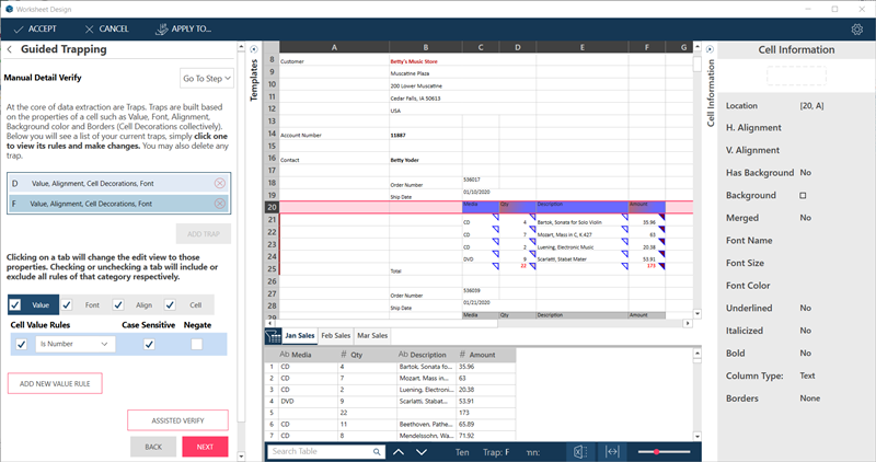

Select Manual Verify to do the trap adjustments yourself.
In Manual Verification, review the components of your trap:
Cell value rules
Font properties
Alignment Properties, and
Cell Properties.
and tweak these so that only the cells rows you want are selected.
Click on tabs (Value, Font, Align, Cell) to display and/or tweak the trap values for each.

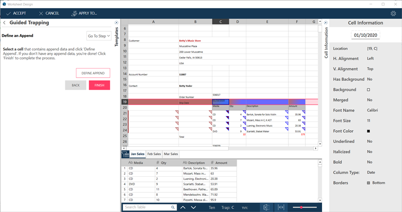

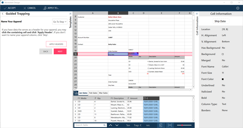

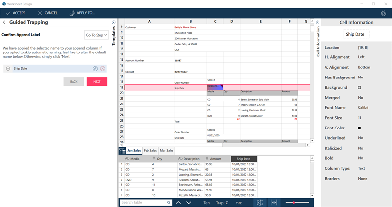

Define your Appends.
Appends are the values that group your details. In our example, sales rows are grouped by Ship Date, then by Order, Contact, and Customer.
The rules for determining details vs. appends are different, but the steps for defining either type are similar.
In this step, select a cell that contains an append value and select Define Append.
After selecting an Append cell, the values are added to your preview:
Select header values and select Apply Headers.
Otherwise, select Next.
If you defined a label, you are asked to confirm it.
Confirm the Append Label and select Next.

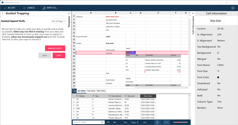

You are asked to verify your Append:
Select Manual or Assisted.
Follow the actions outlined in Step #7 and select Verify Done when complete.

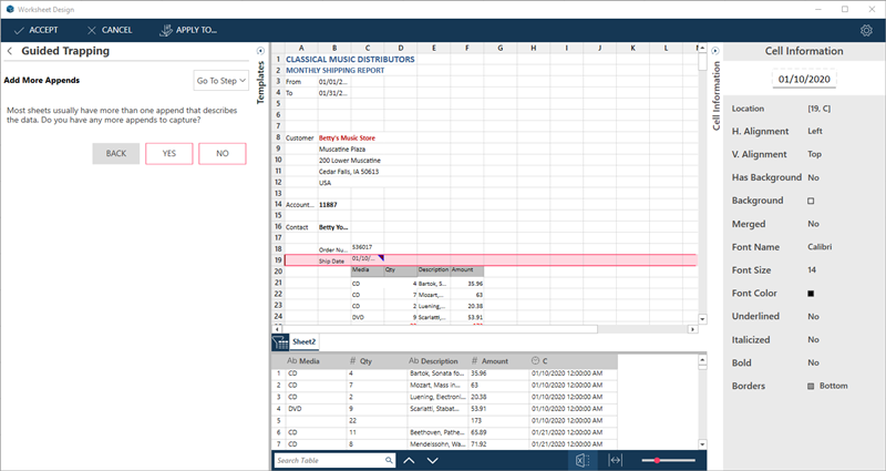

You are asked to Add More Appends.
Select Yes to add more Append columns.
In this case, follow Steps #8-#11.

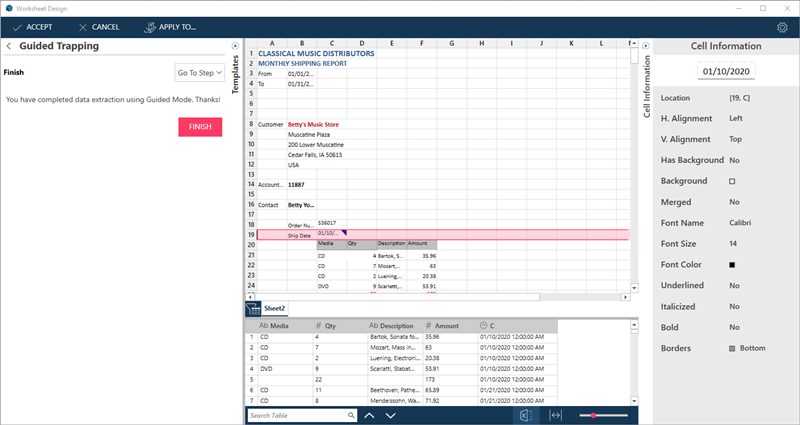

Otherwise, select Finish.

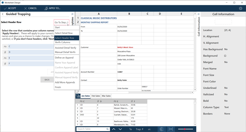

A Note on the Go to Step:
Guide Me shows you how to define templates in a sequential manner. However, you can click on Go To Step at any time to move or jump to a specific step:
This will allow to easily go from one step to the next and tweak specific detail or append templates.
