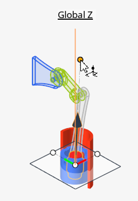

 to Point. Use the edge center point of
                            Pistonrod hole as shown below. A new point
