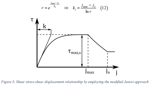

Using the original Janosi approach, the maximum shear strength of the soil, provided by Equation (2), is substituted in Equations (5)-(6) for the calculation of the shear stresses, resulting in the following expressions
However, due to the soil failure, the shear stress decreases above a certain value of shear-displacement [3]. Herein, a simple approach is proposed in order to account for this effect, where the maximum shear strength of the soil constitutes a function of the shear–displacement [3]. Based on this, a modified Janosi approach is derived in the form
where
 corresponds to the value of the shear displacement where the soil
        failure starts and
 stands for the ultimate shear displacement, that is above this
        value the shear stress is unaffected by the shear displacement
. Moreover, the parameter r denotes the maximum shear ratio
In addition, the following expression must hold such that the maximum shear strength, given by Equation (11), corresponds to a continuous function
