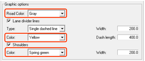

Color of Road Graphic Components:
The components of road graphic (road, centerline, shoulders) can be
assigned different colors by selecting them from the drop-down menu.
