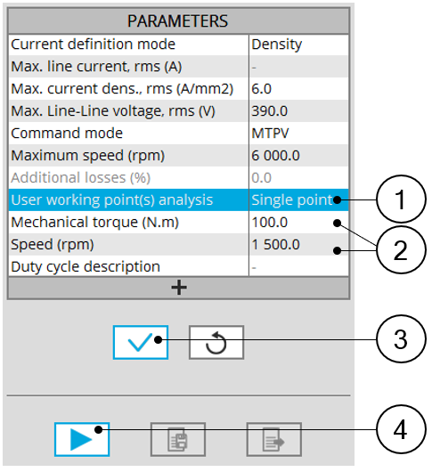

  2. User working point(s) analysis = Single point
    This allows computing the machine performance on a working point which must be specified by the user with the targeted speed and torque.
    In that case the next two fields must be filled in with the targeted speed and mechanical torque.
    User working point analysis = Single point
    1 Select the “Single point” option to perform a computation on one working point.
    2 Define the targeted working point mechanical torque and speed.
    3 Button to validate and take into account the user inputs
    4 Button to run the computation

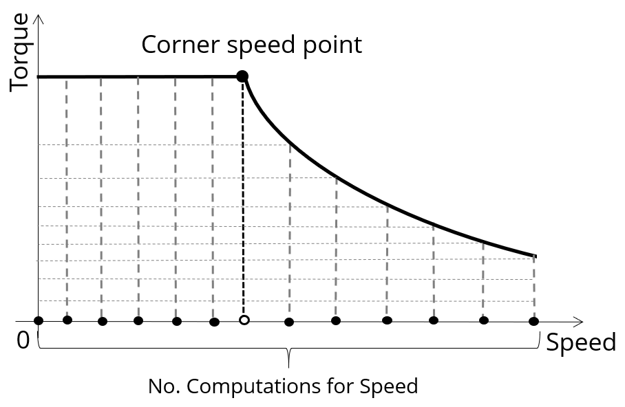

3.2 Number of computations for speed
The “No. comp. for speed” ( Number of computations for speed ) corresponds to the number of points to be considered in the speed range from 0 to the maximum speed.
Half of these points are distributed from 0 to the base speed. The remaining points are distributed from the base speed to the maximum speed.
In both cases, base speed is considered as an additional point.
Note: If the user input parameter “ No. comp. for speed ” is an odd number, one discretization point is automatically removed.
Definition of the number of computations for speed
The default value is equal to 15. The minimum allowed value is 5. The maximum recommended value is 40.

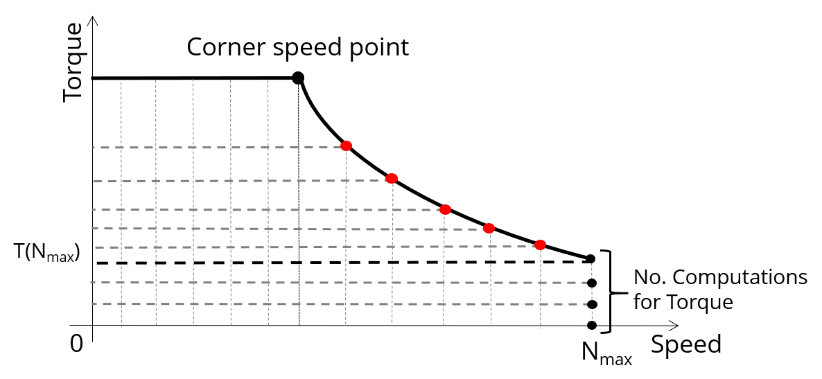

3.3 Number of computation for torque
With the Low Speed command mode, the number of computation for torque is imposed by the input parameter “ No. comp. for torque ” (Number of computations for torque) - Black points in the graph shown below.
The default value is equal to 7. The minimum allowed value is 3. The maximum recommended value is 20.
The number of computation for torque is imposed by the number of computations for speed in the speed range [N base ; N max ] (Red points in the image shown below).
The advanced user input parameter “ No. comp. for torque ” allows to finalize the grid within the torque range [0, T(N max )] at the maximum speed (Black points in the image shown below).
Definition of the number of computations for torque – MTPV command mode
