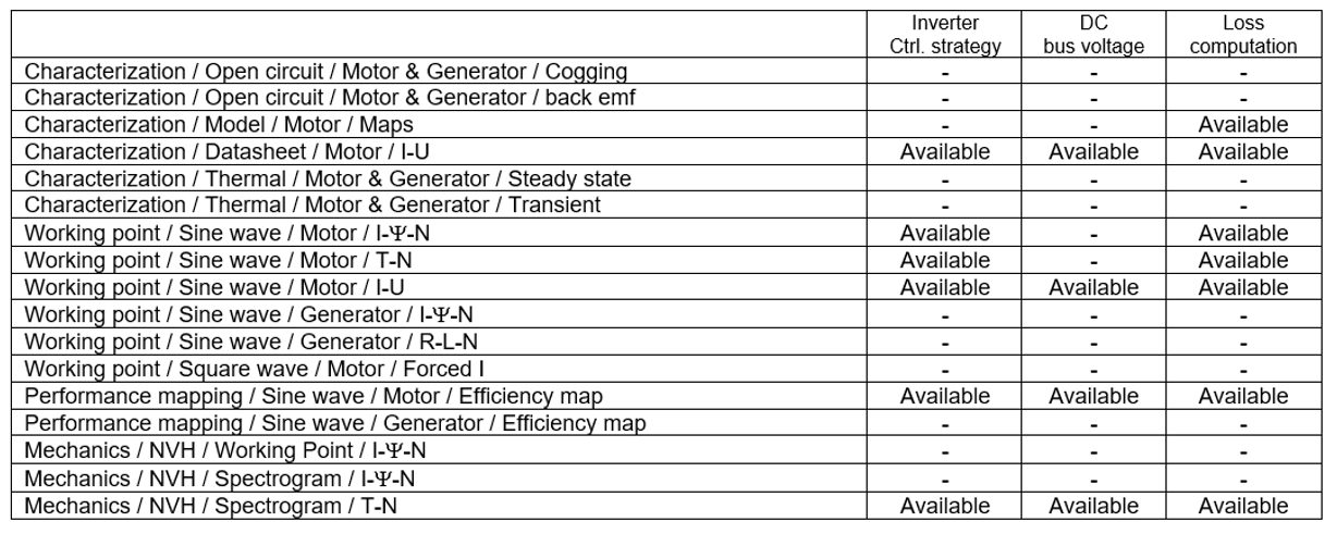

5. Power electronic and tests
The available input parameters dedicated to the power electronics mode depend on the considered test.
Below is the table in which are defined the correspondence between the tests and the input parameters of the power electronics mode.
The whole list of input parameters is illustrated below.
List of input parameters
Correspondence between the tests and the input parameters of the power electronics mode
Note: Loss computation uses Max. efficiency and rated power user inputs
Note: “-“ means the parameter is not used in the considered test
