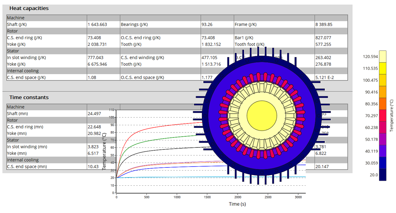

Here are the main results available:
  • Temperature charts versus time – radial and axial view
  • Main temperature curve versus time and final temperature table
  • Heat capacity and time constant table
Illustration of results
