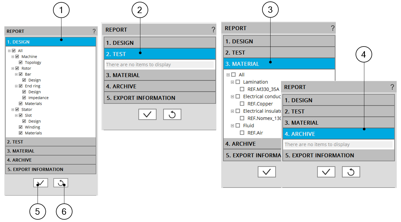

1.1 List of sections available to build the report
| Motor Factory - EXPORT AREA – Export a report – Chapters to be selected | |
| 1 | Chapter which describes the DESIGN. Machine, Rotor and Stator characteristics. |
| 2 | Chapter which describes the TEST results. (At the moment no test is available)All the test results are available as soon as the corresponding computations are performed. |
| 3 | List of materials used to build the machine can be added to the report with all their physical properties. |
| 4 | Archive chapter groups all the tests which have been saved during the
process. These can be added to the report. (At the moment no test is
available)
Note: A maximum of five results per
test can be added to the report.
| 5 | Button to apply the selection of the user input selections (selection of chapters). |
| 6 | Button to restore default values. |

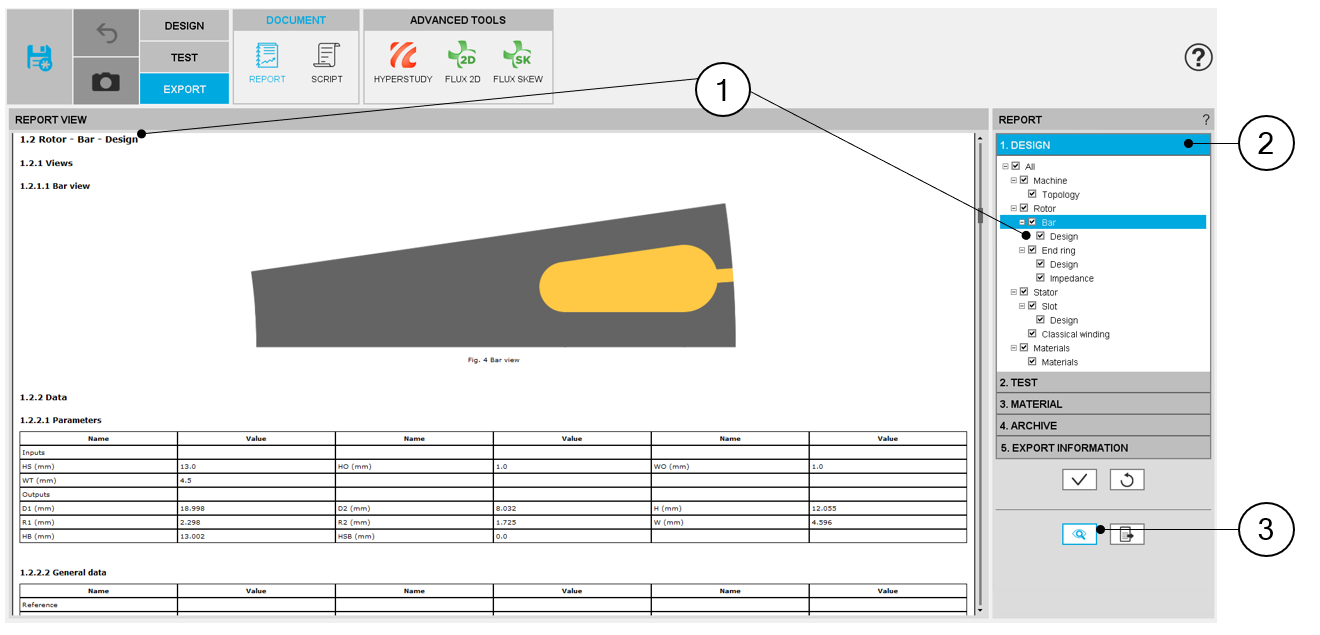

1.2 Selection of sections
| 1 | Section names are shortcuts for displaying the corresponding section of the report |
| 2 | Check the section to add chapters to the report |
| 3 | Button “Preview” considers the selected chapters and displays the report |

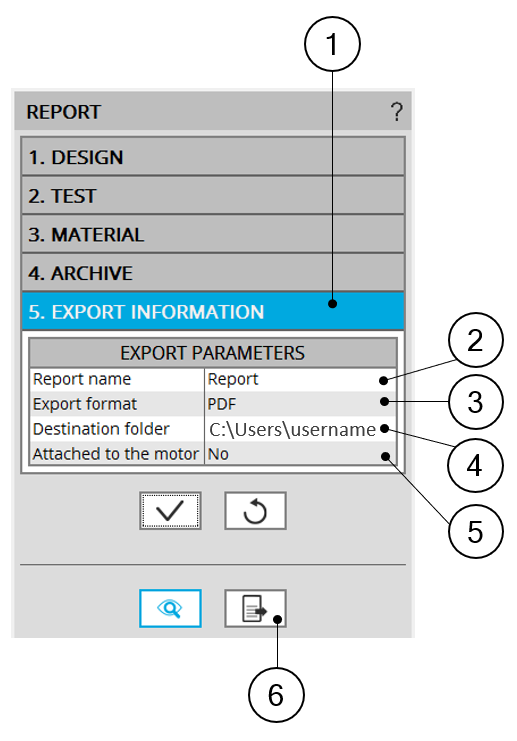

2. Export information
| Motor Factory - EXPORT AREA – Export a report – Export information | |
| 1 | Select the area to define export parameters |
| 2 | A file name must be written (Default name = “Report”) |
| 3 | The file format must be chosen (pdf or html) to build the report |
| 4 | A folder must be selected via the browser for storing the report |
| 5 | It is possible to attach the report (HTML or PDF file) to the motor in the “Motor Catalog” |
| 6 | Button to export the report by considering all the previous defined parameters |
