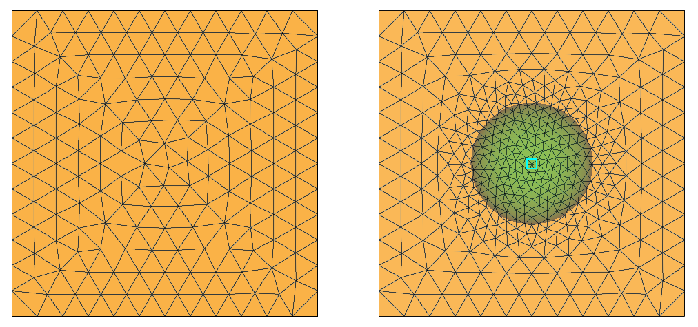

Define a mesh refinement rule around a specified point. Mesh elements in the vicinity
of the point are refined. Mesh refinement around a point is used when only a subset of a
face, edge or wire needs to be refined.
Figure 1. A plate with no point mesh refinement (on the left) and with point mesh
refinement (to the right). The transparent green sphere is the preview when the
Create Point Refinement dialog is open and indicates
the area where the mesh refinement is specified.
On the Mesh tab, in the
Refinement Rules group, click the Point Refinement icon.
Under Position, specify the origin of the point where
the mesh is to be refined.
In the Radius field, enter a value for the radius to
specify the mesh area that is to be refined.
In the Mesh size field, enter a value for the mesh
element length.
Enter a unique label for the point refinement.
Click Create to create the point refinement rule
and to close the dialog.
The mesh refinement rule is added to the model tree,
on the Configuration tab.
