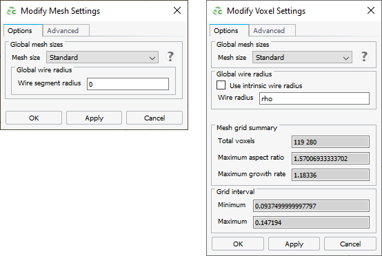

Adjust the auto-generated mesh that is generated when the frequency is set or local
mesh settings are applied to the geometry.
Note:
To generate a tetrahedral mesh, activate the FEM solution method.
To generate a voxel mesh, activate the FDTD solution method.
Open the Modify Mesh dialog using one of the
following workflows:
On the Mesh tab, in the
Meshing group, click the Modify Mesh icon.
Press Ctrl+M to use the keyboard
shortcut.
Figure 1. The Modify Mesh Settings dialog
(Options tab). On the left, the dialog for
triangles and tetraheda and to the right, the dialog for voxels.
Specify the mesh size.
To create a mesh using automatic mesh sizes, in the Mesh
size field, from the drop-down list
select Coarse, Standard or
Fine.
To create a mesh with a custom mesh size, in the Mesh
select Custom. Specify the lengths applicable to the
model.
In the Triangle edge length field, specify
the triangle edge length.
In the Wire segment length field, specify the
wire edge length.
In the Tetrahedron segment length field,
specify the tetrahedron edge length.
In the Voxel size field, specify the length
for the voxel width, depth and height.
Specify the global wire radius.
To specify a wire radius, clear the Use intrinsic wire
radius check box and in Wire radius
field, enter a value for the global wire radius.
To allow the Solver to determine the wire
representation, select the Use intrinsic wire radius
check box.
Tip: This option may improve the FDTD convergence.
Note: A local mesh refinement takes precedence over global mesh settings.
Click OK to modify the mesh and to close the
dialog.
