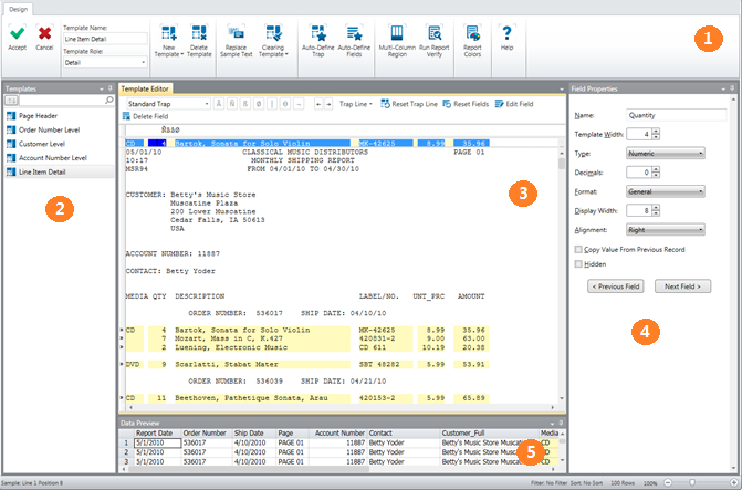

Report Design allows you to create or edit report templates. You go to this mode within Report View.
The Report Design interface has the following elements:
Element |
Description |
[ 1 ] Ribbon |
Displays all the tools you need to work with a report template. Refer to the Report Design Ribbon Quick Reference |
[ 2 ] Selector |
Allows you to search for and/or select a specific template. |
[ 3 ] Template Editor |
Displays the currently-selected template. An action bar at the top of the Template Editor provides tools for defining template traps and fields. |
[ 4 ] Preview Grid |
Displays a sample of the data that will be extracted by the currently-defined templates. The Preview Grid provides quick feedback |
[ 5 ] Field Properties panel |
Displays the properties of the currently selected field on the Template Editor. |
