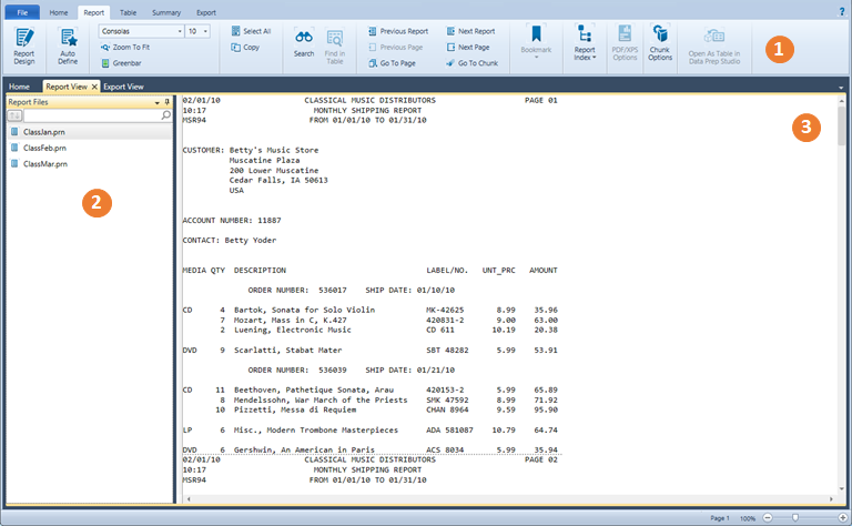

Report View allows you to work with reports. From Report View, you can also click Report Design to create or edit report templates.
The Report View interface has the following elements:
Element |
Description |
[ 1 ] Ribbon |
Displays all the tools you need to work with a report. Refer to the Report View Ribbon Quick Reference. |
[ 2 ] Selector |
Allows you to search for and/or select a specific report to view. |
[ 3 ] Report View |
Displays the currently-selected report. |
