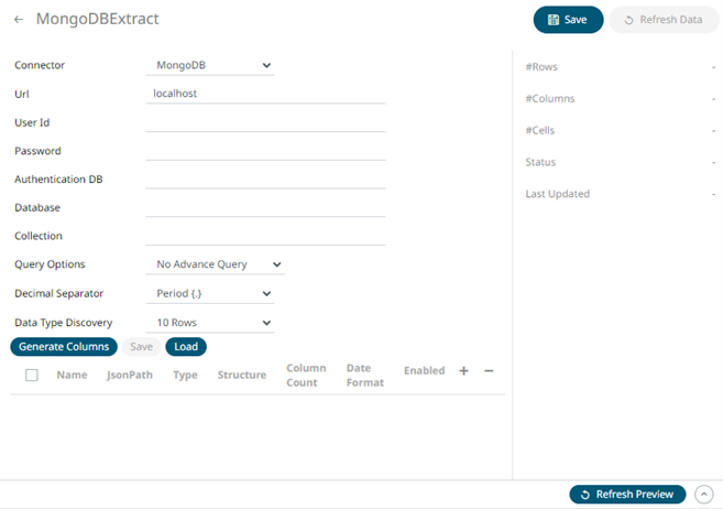

1.     On the New Data Extract page, select MongoDB in the Connector drop-down list.
2.     Enter the following properties:
Property
URL
Enter either:
·         localhost if the database resides on the same computer, or
·         enter the IP address and port of the computer where MongoDB is installed (e.g., 192.168.1.1:27017). If no port is specified, the default is 27017.
User Id
The user Id that will be used to connect to MongoDB.
Password
The password that will be used to connect to MongoDB.
Authentication DB
The database where the user is created.
Database
The database that will be used.
Collection
The collection that will be used.

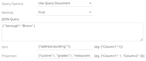

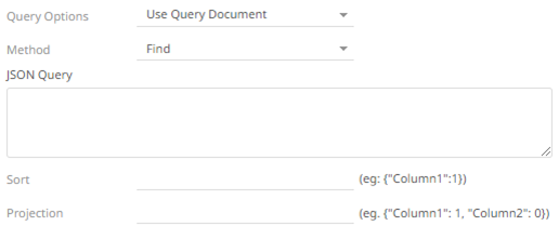

3.     To make the Query Document feature of MongoDB available in Panopticon, select Use Query Document.
The Plugin Settings pane updates to display the settings of this query option.
For the Method option, select any of the following values:
·         Find (Default)
Allows you to fetch a document from a MongoDB collection.
Two more configurable settings are available:
¨        Sort
Provide a JSON object that defines the sort criteria, then set the order to either 1 for ascending or -1 for descending (e.g., {"address.building":1}).
¨        Projection
Provide a JSON object to include or exclude from the result of the Find query.
For example, if a document has 9 documents and you only need to display 5, you can either:
o    select 5 JSON objects, then set the limit value to 1 to display
{"cuisine":1, "grades":1, "restaurant_id":1, "name":1, "borough":1}
o    select 4 JSON objects then set the limit value to 0 to hide
{"address.zipcode":0, "address.coord":0, "address.street":0, "address.building":0}
   NOTE
_id field is always displayed while executing the Find method. You can opt to set this field to 0 to hide it (e.g., {"_id":0}).

4.     Instead of using Use Query Document, select the Parameterize query option.
Click  to populate the Parameter drop-down and select a value. Then select what column to filter on in the Filter By drop-down.
5.     Select either the dot (.) or comma (,) as the Decimal Separator.
6.     Select the Data Type Discovery. This property specifies how many rows to fetch from the input data source, when auto generating the schema after clicking  .
7.     You can also opt to load or save a copy of the column definition.
8.     Click . A new row displays in the JSON list box. Enter the necessary information for each column.
