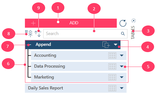

Working with the Table Selector
The Prepare Window displays a table selector to the left of the screen that looks like this:
Note this interface is common for all tables, no matter if the data source is a report, XML,JSON, PDF, Excel, or database. However, the context menus may vary slightly and these variations are discussed below.
Table selector icons
Icon |
Description |
1 |
Add Button Clicking this button allows you to open and add new tables to your workspace. |
2 |
Search Bar You can search for specific tables from the table list by entering the name or first few letters of the name of the table of interest into this field and then pressing ENTER on your keyboard. When a search is performed, all load plans are expanded and tables that match the search criteria (or the part of the table that matches the criteria) are highlighted. |
3 |
Click this icon to hide or unhide the table list panel |
4 |
Table Actions Click on this button to reveal a list of actions you can perform on your table. Note that the actions you can perform vary according to the table type and source. |
5 |
Table Menu Clicking on the drop-down buttons located to the right of each table icon displays a menu that lists the table's source and name, row limits (if any), and other buttons that allow you to carry out a number of table actions. Actions will vary depending on the table type selected. |
6 |
Load Plan A load plan provides users with a hierarchical view of all of the operations performed on a table. This functionality allows users to easily track, modify, remove, and duplicate tables,especially those obtained through Transform Data and Combine operations. |
7 |
Expand/Collapse Load Plan Click to expand or collapse the selected Load Plan, a graphical representation of the tables that make up a table and actions that have been carried out to arrive at the set of data. |
8 |
Collapse/Expand All Load Plans Clicking this button allows you to collapse/expand all load plans in the workspace. |
9 |
Sort Button Sort the tables in your Table list by clicking on this button. You can sort in ascending or descending order or remove an applied sort order. |

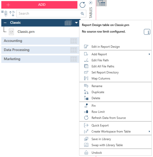

Table actions
When the drop-down arrow beside a table in the Table list is clicked, information about that table, including its source, name, and row limit, is displayed. An action menu is also made available, as shown in the figure below:
Actions for Basic Tables
Note that different table types display different actions. The table below describes the actions you can do to basic tables.
Action |
Description |
Object Description |
Clicking on the Object Description icon launches a text field into which you can enter a comment or description of the selected table. |
Allows you to modify how data from a some file formats should be imported into your workspace. Some of these settings include: For MS Excel tables:
For MS Access tables:
For delimited text tables:
For HTML tables:
Edit Table Info |
Allows you to select a different table from a given datasource. Note: If your table has been deprecated, this option is disabled. |
Allows you to provide the necessary details for tables requiring security credentials that were cleared when the workspace was saved. |
Allows you to change the path to a data source. |
Edit All File Paths |
Allows you to change the path to all open data sources. |
Map Columns |
Allows you to map the columns of two tables with dissimilar schemas without breaking an existing change list. |
Rename |
Allows you to change the name of a table. |
Duplicate |
Allows you to create a new instance of the table. The duplicate is initially named <TableName>n, where n is number that indicates how many instances of the table are currently in use . You can rename the table after duplication. |
Delete |
Allows you to delete the selected table. |
Pin |
Allows you to pin a table. When you do so and the workspace is saved, a user without direct access to the table source may open the pinned table when he opens the workspace. |
Row Limit |
Allows you to increase or decrease the rows displayed by Monarch Data Prep Studio for the current table. Decreasing the row limit can speed up the load time of the table and improve the response time when carrying out operations. However, this may allow you to miss exceptions and problematic rows, if these are not included in the limited row set. |
Refresh Data From Source |
Allows you load the latest data from your data source. Use this option if the values in your table are changed via an external application and you want these changes reflected in your workspace. |
Quick Export |
Allows you to quickly export the selected table into a number of formats via the Select an Export Type dialog. |
Create Workspace from Table |
Allows you to export tables to a new workspace. |
Save in Library |
Saves the data source in the Data Source Library. You can use the Data Source Library to easily access and include commonly-used data sources as you define workspaces without having to open the data source and load tables. |
Swap with Library Table |
Allows you to replace the selected table with one from the Data Source Library. |
Undock |
Undocks the table from the Monarch Data Prep Studio work area so that you can:
