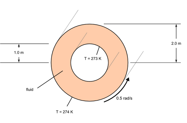

The problem consists of a viscous fluid filling the annulus between two concentric cylinders, as shown in the following image, which is not drawn to scale. The inner cylinder has a radius of 1.0 m and is fixed in place. The outer cylinder has a radius of 2.0 m and rotates with a constant angular velocity of 0.5 rad/s. The inner cylinder is held at a constant temperature of 273 K and the outer cylinder is held at 274 K.

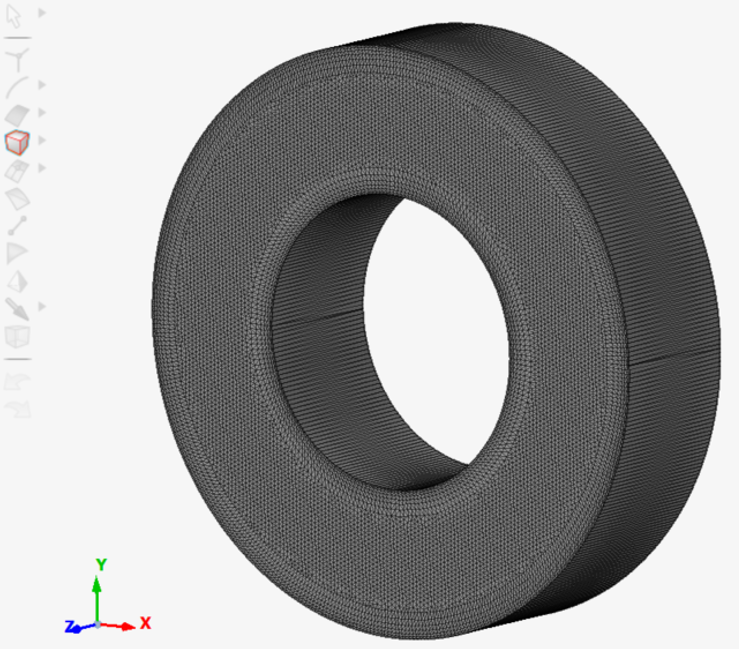

Figure 2. Mesh used for Simulating Viscous Heating Inside a Rotating Annulus

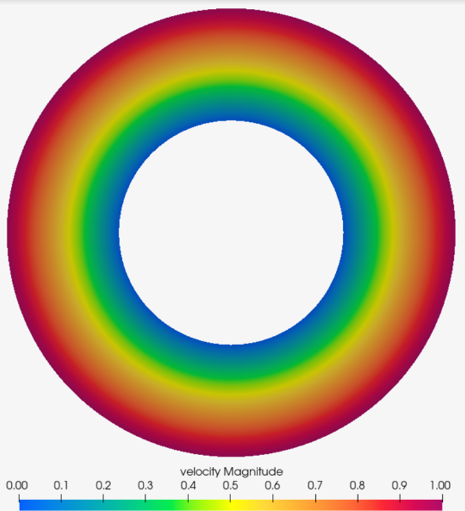

Figure 3. Contours of Velocity Magnitude (m/s)

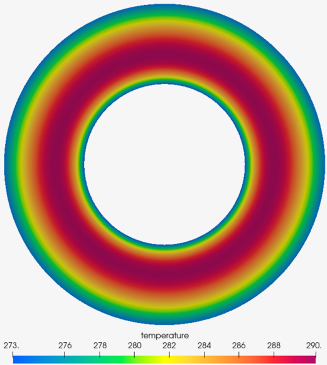

Figure 4. Contours of Temperature (K)
