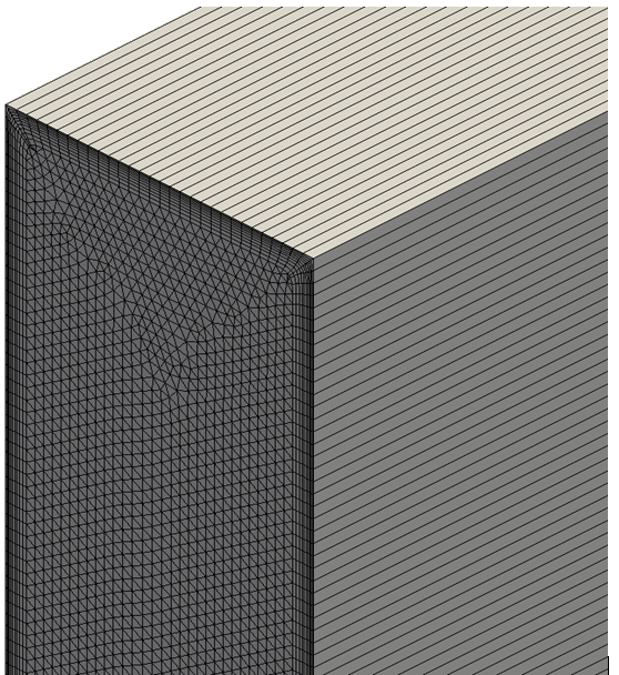

![](../../images/acusolve/turbulent_natural_convection_inside_a_tall_cavityf2.png)
Figure 2. Mesh used for Simulating the Natural Convection of Turbulent Flow in a Tall Cavity

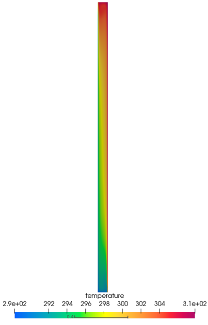

![](../../images/acusolve/turbulent_natural_convection_inside_a_tall_cavityf3.png)
Figure 3. Temperature Contours Throughout Tall Cavity in the X-Y Plane

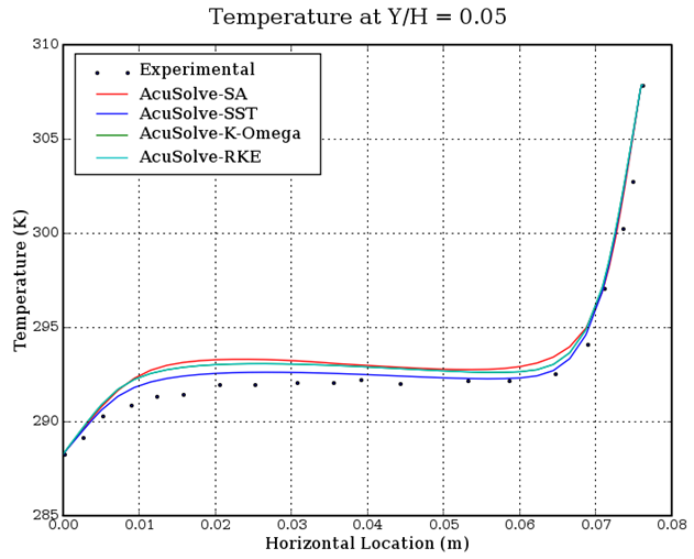

![](../../images/acusolve/turbulent_natural_convection_inside_a_tall_cavityf4.png)
Figure 4. Temperature Plotted against Location along Horizontal at a Position of y/H=0.05 in the Cavity, where H is the Cavity Height and y is the Distance from the Bottom Wall

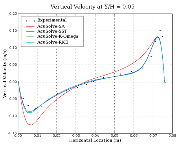

![](../../images/acusolve/turbulent_natural_convection_inside_a_tall_cavityf5.png)
Summary
In this application, turbulent flow developed by natural convection, at a Rayleigh number of 8.6X105, is studied within a tall cavity. The AcuSolve results compare well with the experimental data for temperature and vertical velocity along a horizontal line at a location of y/H=0.05 in the tall cavity, with the two-equation models capturing the velocity gradient with greater accuracy. A temperature difference occurs within the flow region due to the heat transfer from the vertical walls of the cavity. The hotter, less-dense air rises to the top of the cavity while the colder, denser air sinks to the bottom, giving rise to recirculation. AcuSolve demonstrates the ability to accurately predict the natural convection of turbulent flow within a tall cavity.
