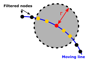

| Move limit | Define an area where the nodes can move, this area may be defined
                                    by:
| Sensbilities filter | Define an area where the nodes will move in an average direction
                                composed of each node directions, this area may be defined as:
                                    defined by:
                                    direction composed of each node directions, this area may be
                                    defined as:
