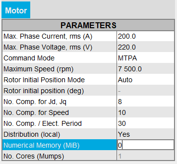

Input parameters: Numerical Memory
Numerical memory allocated to the solving process of the Flux project:
Since FeMT 2021, there is a new memory mode to run tests: the Dynamic memory mode.
From now on, there are two memory modes: User (static) and Dynamic.
- If the User (static) memory mode is used, then the
numerical memory value (in MiB) allocated to the solving process of the Flux
project is displayed. The user can modify this value.
On the other hand, the user can switch to the Dynamic numerical memory mode by entering 0.
Note: For FeMT versions prior to 2022.1, the user could not switch to the Dynamic memory mode in FeMT. In order to run tests in Dynamic memory mode, the user had to regenerate the coupling component from a Flux running in Dynamic memory mode. - If the Dynamic memory mode is used, then
Dynamic is displayed and the numerical memory used is
dynamically managed by Flux during its execution. So in this mode, the user does
not set any value for the numerical memory.
On the other hand, the user can switch to the User numerical memory mode by entering a numerical value in MiB.
Warning: When switching from Dynamic numerical memory mode to User numerical memory mode, the user must know the numerical memory required to solve the project and therefore set a high enough value.
Note: For FeMT versions prior to 2022.1, the user could not switch to the User memory mode in FeMT. In order to run tests in User memory mode, the user had to regenerate the coupling component from a Flux running in User memory mode.

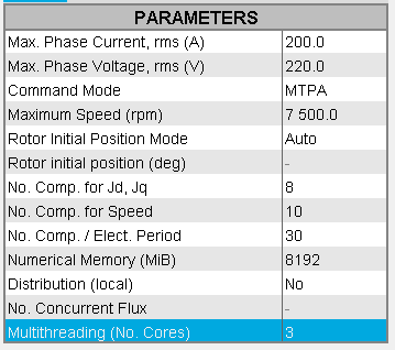

Input parameter: Multithreading (No. Cores)
This field defines the number of cores used during a solving. More precisely, it is the number of cores used by the application for multithreaded algorithms. The application uses at least 1 core.
- If the Distribution (local) is set to
Yes
- If in the field Multithreading (No. Cores per
Flux) there is a value m,
(note: this value is not accessible to the user here, it is
grayed out), then this indicates that the distribution has
already been configured i.e. that this value has been previously
set in the Flux Supervisor. So, for the solving,
m cores per concurrent Flux will be used.
- If in the field Multithreading (No. Cores per Flux) there is no value, then this indicates that the distribution has not been activated in the Flux Supervisor. And so the solving will be sequential and not distributed even if the Distribution (local) is set to Yes.
Note:- In order to configure the distribution in the Flux Supervisor
and define the number of cores per concurrent Flux:
- either use the Distribution Manager button
- or use the Options button and in System / Parallel computing, click on the Set local resources button
and possibly click on the Allow button and then define the Number of cores per concurrent Flux and click on the Use button
- In order to deactivate the distribution in the Flux
Supervisor:
and possibly click on the Do Not Allow button or click on the Stop Using button
No then the solving will be sequential and not
distributed.
However, even if the solving is sequential, the number of cores will be used for multithreaded algorithms.
Default values are set for the field Multithreading (No. Cores):- For a 2D project, the number of cores is 1 by default
- For a Skew project, the number of cores is 2 by default
- For a 3D project, the number of cores is 4 by default
This value corresponding to the number of cores can be modified by the user. The maximum value the user can enter is of course the total number of cores of the machine.
