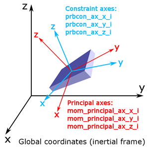

Depending on the complexity of the case and the data you have available, you may need to specify 0, 1, or 2 additional coordinate systems.
The Cartesian coordinate system, which is commonly referred to as a global coordinate system or global reference frame, is the default coordinate system in which the code is operating and does not need a definition. It is assumed that it coincides with the inertial frame of reference.
- mom_principal_ax_x_i "x y z"
- mom_principal_ax_y_i "x y z"
- mom_principal_ax_z_i "x y z"
Where, the “x y z” coordinates represent the unit vectors expressed in global coordinates. The suffix “i” at the end of the command stands for “inertial”, to indicate which coordinates to use when defining the unit vector components.
- prbcon_ax_x_i "x y z"
- prbcon_ax_y_i "x y z"
- prbcon_ax_z_i "x y z"
Figure 1. Coordinate Systems used for PASSIVE_RIGID_BODY and the Respective Definition Commands. In general, it is not necessary for the three coordinate systems to align.

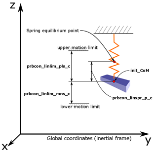

Linear or torsional springs can also be defined. To illustrate the basic concept of such a setup, refer to Figure 4. The example shows the setup of a body which is hanging on a spring. The initial location of the body does not correspond to the equilibrium point of the spring, that is to say that you have a pre-deformation of the spring (prbcon_linspr_p_c) when starting the simulation. Along with this you of need to set the stiffness coefficient of the spring (prbcon_angspr_k_c). Between these two parameters you can define a force that is initially acting on the spring. Same principles apply for torsional springs, except that the deformation is expressed in [rad], and the stiffness of the spring in [Nm/rad].
Figure 4. Linear Spring Setup with Annotated Commands
