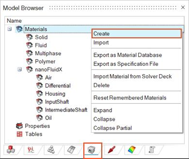

Create Materials
- From the Model Browser, click
. - From the Analysis ribbon,
Material group, click the
Material tool.
Figure 2. - On a selected body, right-click and select context menu. The
Create Material dialog opens and shows the material
properties and phase settings.Note: Three different materials types are available under Model: Fluid, Moving Wall, and Wall. The properties displayed in the Create Material dialog are controlled by the physics selected in the SPH Solution. Activating Surface Tension, Adhesion, or Temperature will mean more properties are required in the Create Material dialog.
