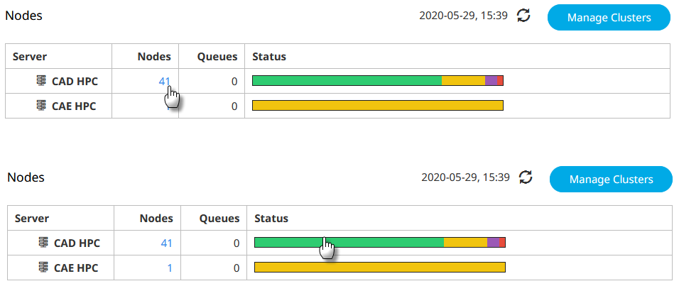

Drill Down to Node Details for an HPC Cluster
Drill-down to a get detailed information about the HPC cluster's nodes such as the state of the node, and the availability of CPUs and memory.
Drill-down for detailed node information for all cluster nodes or nodes in a specific condition.

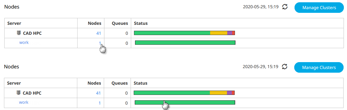

Drill Down to Nodes Attached to a Queue
Drill-down to view node details of nodes that have been attached to a queue.
Drill-down to see all nodes that have been attached to a queue or nodes attached to a queue that are in a specific condition.

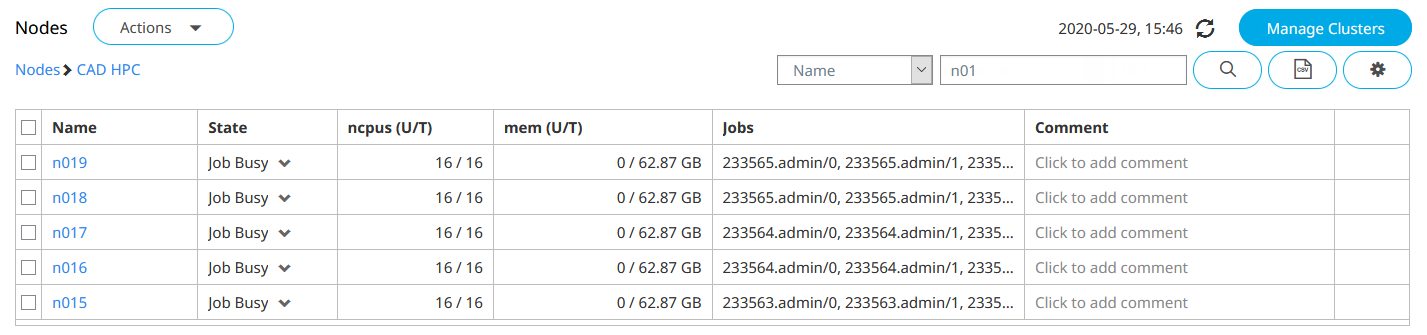

Understand the Node Detail View
A detailed view of an HPC cluster's nodes including the state of the node and resource availability.
- the name of the node
- the state of the node
- number of CPUs being used / total number of CPUs present on the node
- amount of memory being used / total memory present on the node
- a comma separated list of the jobs running on the node in the format jobid/cpu_no where cpu_no identifies the CPU that is being used by the job. CPUs are numbered from 0 to n.
- comments added by the WLM administrator or the WLM itself about the node
Presently, node management cannot be done at the vnode level, therefore you cannot select a vnode to take it offline or place it online.
Figure 3. Node Details
