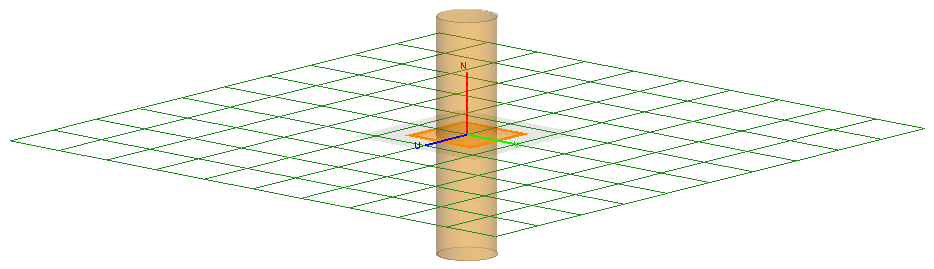

- Create a cylinder.
- Split the cylinder to create two sections.
CADFEKO automatically adds a face on the split plane to keep the two split parts as solid parts. Alternatively, before splitting, the region of the cylinder should be set to free space. Then model the cylinder as a shell and not a solid so no extra face is created.
Figure 1. The preview of the split operation on the thick dipole. - Union the two sections to ensure the faces in the edge port belong to the same part.

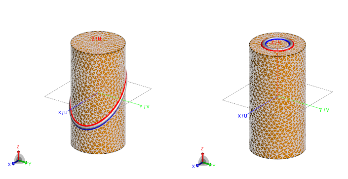

Figure 2. Delete the extra face which was created when the two sections were unioned. - Add edge port.Specify the outer face of the one section as the positive face. Specify the outer face of the second section as the negative face. The result is an edge port which is not straight but closes on itself.
Figure 3. An edge port is added to the thick dipole. Note the edge closes on itself.

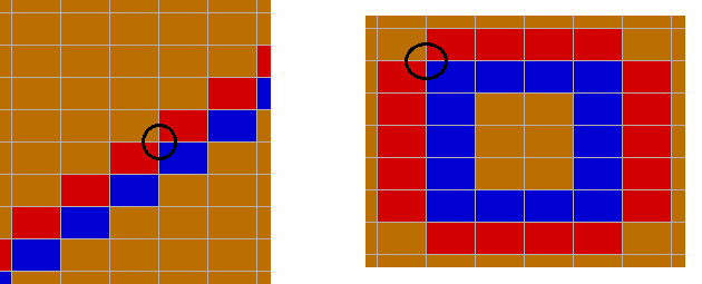

![](../../../../images/feko/user_guide/cadfeko/image_port_edge_voxel_invalid.png)
Figure 6. If a voxel mesh is applied to the same model as the top example and a similar edge port is specified, it results in an invalid edge port as displayed in the section views. The black circles indicate an example of a point with conflicting potentials.
