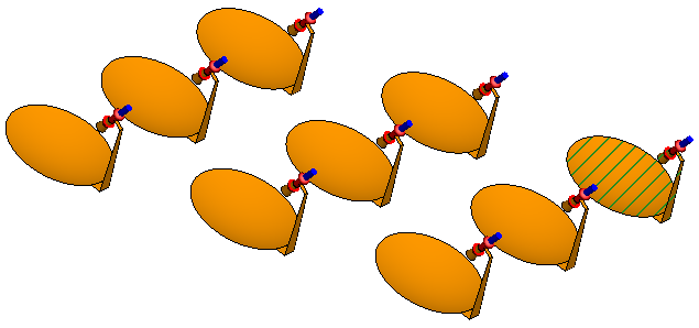

Finite Antenna Arrays
Create an arbitrary finite antenna array that consists of an array of contributing elements, either with direct feeds for each element or via indirect coupling, and solve with the efficient domain Green's function method (DGFM).
![](../../../../images/feko/user_guide/cadfeko/image_antenna_array.png)
The DGFM solver method considers the self-coupling, mutual coupling and the edge effects of the finite array, but only uses the computational resources equivalent to solving the base element.
