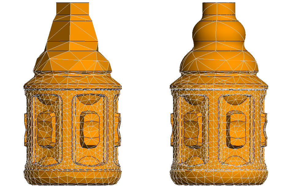

![](../../../../images/feko/user_guide/cadfeko/image_mesh_triangle_curvilinear.png)
Figure 1. A model with flat triangular mesh (on the left) and with curvilinear mesh and higher order basis functions enabled (to the right).

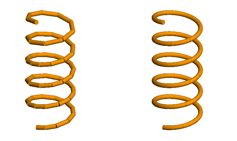

![](../../../../images/feko/user_guide/cadfeko/image_mesh_segment_curvilinear.png)
Figure 2. A helical wire meshed with straight segments (on the left) and with curvilinear mesh segments (to the right).
