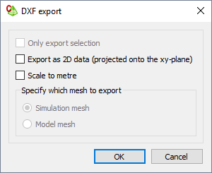

Figure 1. The DXF export dialog.
If a geometry part or mesh part was selected in Step 1, the Only
export selection check box is selected.
[Optional] To export all included meshes, clear the Only export
selection check box.
Select the Export as 2D data (projected onto the
xy-plane) check box to export the model as two-dimensional
data.
[Optional] To export dimensions in metre, select the Scale to
metre check box.
If the model contains mesh parts (imported meshes) and simulation meshes
(meshed geometry or remeshed mesh parts), the options under Specify which
mesh to export are enabled.
Under Specify which mesh to export, select one of the
following:
To export the meshed model of the geometry or the remeshed version of an
imported mesh, click Simulation mesh.
To export an imported mesh, click Model mesh.
Click OK to export the mesh outline and to close
the dialog.
