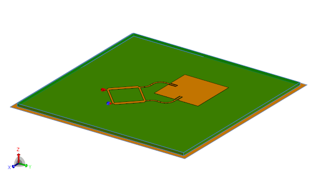

![](../../../../images/feko/example_guide/EG_E04_non_radiating_network_feed_structure/intro.png)
Figure 1. 3D view of the patch antenna with feed network in CADFEKO.
