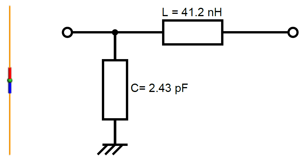

Match a short dipole for resonance at 1.4 GHz with an LC matching section. The matched network is modelled using a Spice circuit and S-parameters.
![](../../../../images/feko/example_guide/EG_E03_matching_non_radiating_network/intro.png)
Figure 1. 3D view of the dipole (left) and the schematic representing the matching network used at the port (right).
