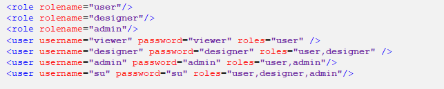

6.     For a basic install using the Tomcat inbuilt XML file user directory, copy the provided tomcat-users_example.xml and overwrite the existing tomcat-users.xml file which is available in the Tomcat config folder (\Apache Software Foundation\Tomcat 9.0\conf).
The provided tomcat-users_example.xml contains the following roles and users:

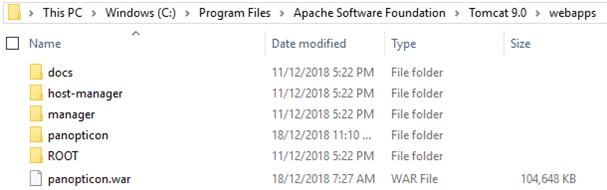

8.     Start Tomcat to deploy the .war file.
The panopticon folder is extracted in the Tomcat webapps folder:
The server initializes the AppData directory with an empty content repository and empty subdirectories for other types of data. The Panopticon.properties file is created with the default server properties.

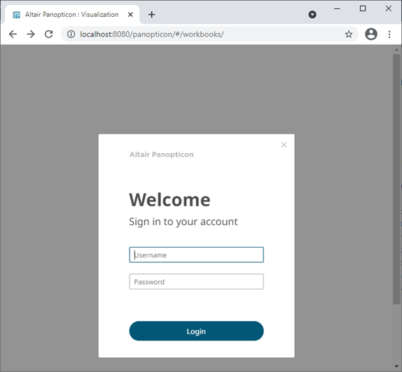

10.   You should now be able to log on to the Panopticon Visualization Server using the following:
[Host Name]:[Port]/[Name of your application]
For example:
http://localhost:8080/panopticon

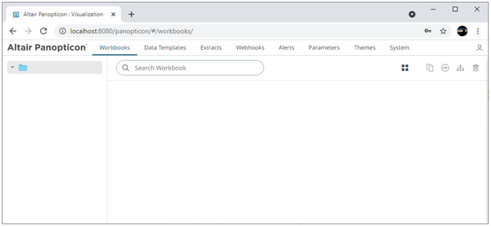

The Panopticon Visualization Server supports different user roles. To have full access to all the services, the user is required to have an ADMINISTRATOR and DESIGNER roles.
For example, logging on using the ADMINISTRATOR role added in step 6 (i.e., admin/admin), will display:
All of the available user specific folders in the authentication method used are displayed.

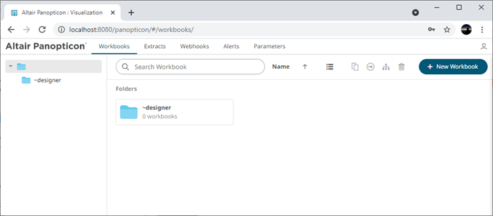

However, logging on with a DESIGNER role (i.e., designer/designer) will only display:
The allowed features available for the DESIGNER role is extensively discussed in the Web Authoring Guide.
