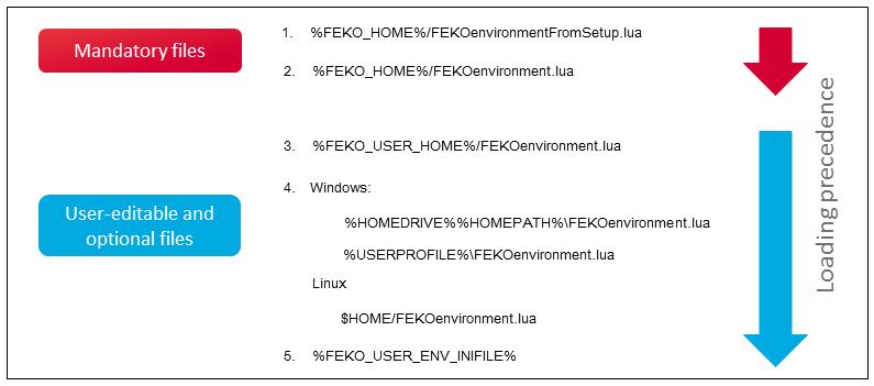

The Lua scripts are loaded in the following order:
FEKO_HOME/FEKOenvironmentFromSetup.lua
This mandatory file is created at installation time. It contains the global
default settings for the current installation. It is not advised to edit this
file, unless a different setting is required than specified during
installation.
FEKO_HOME/FEKOenvironment.lua
This mandatory file is provided and managed by Feko
to ensure correct functionality. This file may be updated by the update utility,
so any changes to it may be lost.
FEKO_USER_HOME/FEKOenvironment.lua
This is an optional file. It must be created by the user if and when
required.
Windows:
%HOMEDRIVE%%HOMEPATH%\FEKOenvironment.lua
It must be created by the user if and when required. If it is not found, it will
be silently ignored and operation continues.
%USERPROFILE%\FEKOenvironment.lua
Linux:
$HOME/FEKOenvironment.lua
FEKO_USER_ENV_INIFILE
