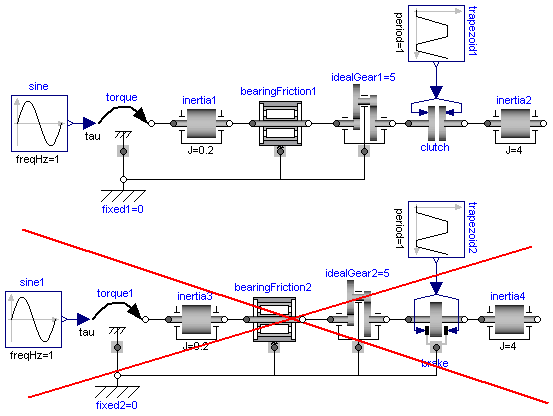

The elements of this library can be connected together in anarbitrary way. However, difficulties may occur, if the elements which can lock therelative motion between two flanges are connected rigidlytogether such that essentially the same relative motion can be locked.The reason isthat the cut-torque in the locked phase is not uniquely defined if theelements are locked at the same time instant (i.e., there does not exist aunique solution) and some simulation systems may not beable to handle this situation, since this leads to a singularity duringsimulation. Currently, this type of problem can occur with theCoulomb friction elements BearingFriction, Clutch, Brake, LossyGear whenthe elements become stuck:
driveConnections3
In the figure above two typical situations are shown: In the upper part ofthe figure, the series connection of rigidly attached BearingFriction andClutch components are shown. This does not hurt, because the BearingFrictionelement can lock the relative motion between the element and the housing,whereas the clutch element can lock the relative motion between the twoconnected flanges. Contrary, the drive train in the lower part of the figuremay give rise to simulation problems, because the BearingFriction elementand the Brake element can lock the relative motion between a flange andthe housing and these flanges are rigidly connected together, i.e.,essentially the same relative motion can be locked. These difficultiesmay be solved by either introducing a compliance between these flangesor by combining the BearingFriction and Brake element intoone component and resolving the ambiguity of the frictional torque in thestuck mode. A tool may handle this situation also automatically,by picking one solution of the infinitely many, e.g., the one wherethe difference to the value of the previous time instant is as smallas possible.
