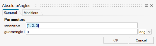

sequence = {1,2,3} // Cardan or Tait-Bryan angle sequence = {3,1,3} // Euler angle sequence = {3,2,1}Parameters
mo_sequence | sequence | Angles are returned to rotate world frame around axes sequence[1], sequence[2] and finally sequence[3] into frame_a | Vector of size 3 | |
mo_guessAngle1 | guessAngle1 | Select angles[1] such that abs(angles[1] - guessAngle1) is a minimum | Scalar |

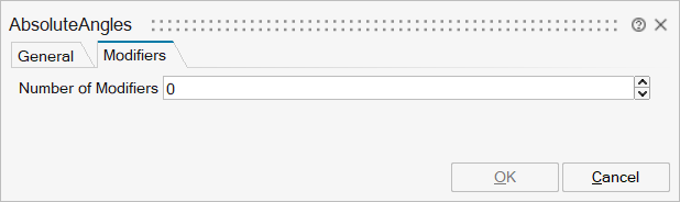

mo__modifiers/value | Value |
